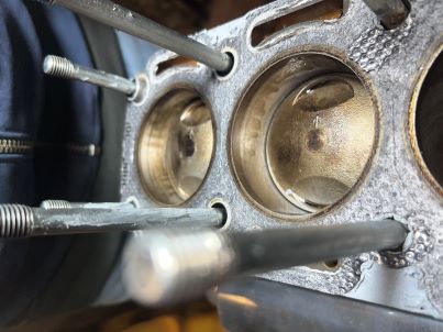

Hi Kawboy, OK at this time I have some photos to downsize, so it will enable me to post them on here. Have been measuring valve stems, as said before. Wobble tests done, about 4 of the exhausts look to be very close to maximum and probably over the limit. Just waiting for my micro bore gauge to arrive.
Now for what i will be posting in the photos ! the cylinders are still in place. So with a friend helping me, we still have oil in the sump its reading the lower mark in the oil sight glass. Obviously head removed.
Turning the engine over, that's my friend withe the crank nut. Me letting the cam chain running over my hands.
After about two turns, It became very obvious !!!! most of the cylinders were showing lot's of oil up the cylinder walls, As if the oil rings were stuck in ! worst were #1-2 as i said before lots of smoke from left hand exhaust.
So how much oil was being thrown up @ a few 1000 rpm ? Oval bores NO, I have measured front to back and side to side. But to be fair , not removed the cylinders yet.
Have you ever come across this before ? is it possible for the oil rings to be stuck. It seems to have got worse over the years. But as said before, the person who i got the bike off it was standing for many years.
I will post the photos very soon. Thanks again
