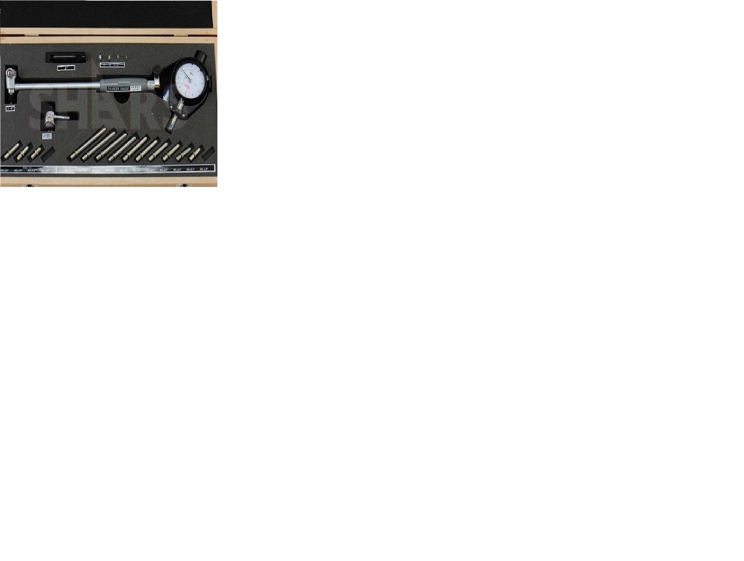

Something's goofy with the numbers. Piston diameter is .02mm larger than the bore????
Bore diameter is less than 62mm?? I would have expected a bore diameter of 62mm - 62.03mm on a new cylinder. Used cylinder in good shape - 62.05mm, cylinder in reasonable shape but well worn 62.1mm
When you checked the ring end gap, did you square the ring up to the bore by inserting the ring in the bore and then used the piston crown to push the ring square to the bore before measuring??
Never heard of rings wearing thin in the vertical plane, so that tells me someone else had a go at doing a ring job and fitted new rings that were not 1.00mm thick.
Did you use a dial bore gauge like this one to measure the cylinders and use a 2-3" mic to set up the dial bore gauge??

Ok Kawboy, see where you are coming from . This maybe the instrument used, the new caliper is 100% I've tested it with gauge plates. But it could be the internal bore gauge. This is the T type with the spring loaded arm, that you lock at the specific diameter then measure out of the bore. ?
When you checked the ring end gap, did you square the ring up to the bore by inserting the ring in the bore and then used the piston crown to push the ring square to the bore before measuring?? Yes exactly as stated in the manual.
Also the Top ring was not marked with the way up indicator, and no chamfer on the ring edge either !! the inside of the ring where it fitted into the piston ring groove was thinner than the outer edge. So much you can see it !
No Kawboy, I don't have the use of this instrument . As stated above.
