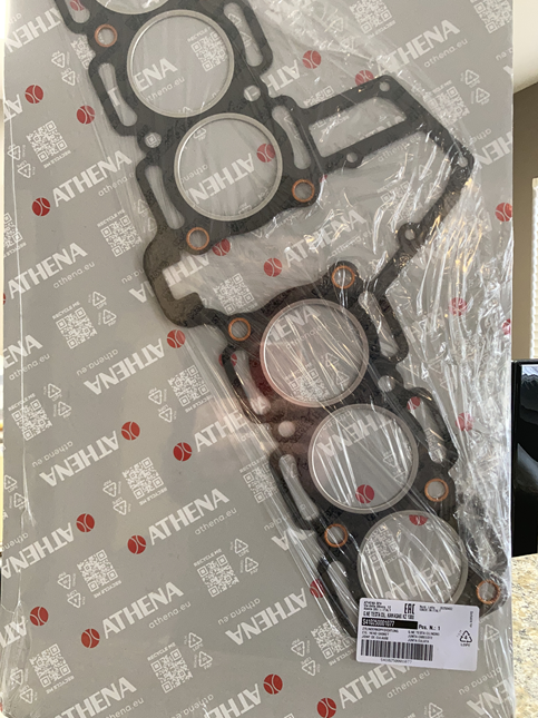

Brixamoto sells head gaskets made by ATHENA
