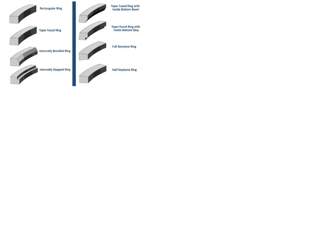

As for the rings- it sounds like you have a set of keystone profile rings in there. I'm not up on this particular style of ring, but AI suggest it's primarily used on diesel piston s to break up carbon deposits. How you ended up with these rings is beyond me. See pic??

Top ring on #1 looks to be a mixture of internally stepped ring and the full keystone ring. looks so wrong in every way. Just checked out #6 Top ring, looks more normal but ring end gaps failed miserably . Piston groove well within limit.
