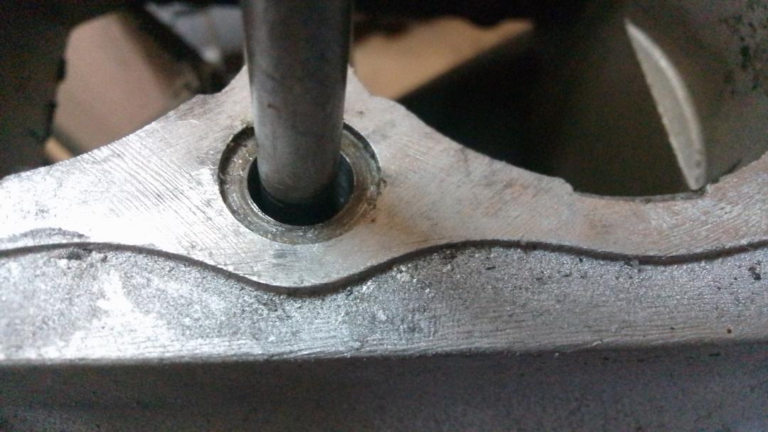

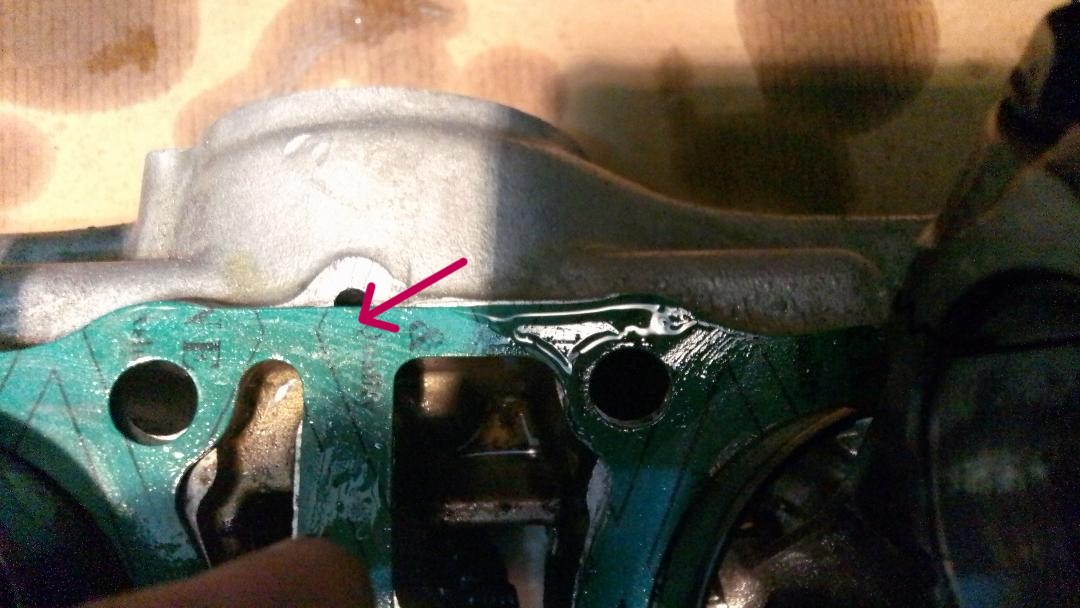

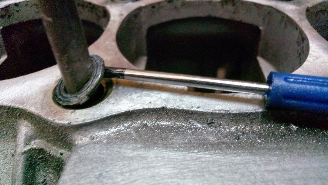

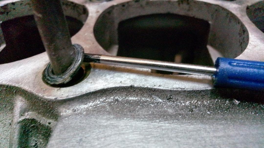

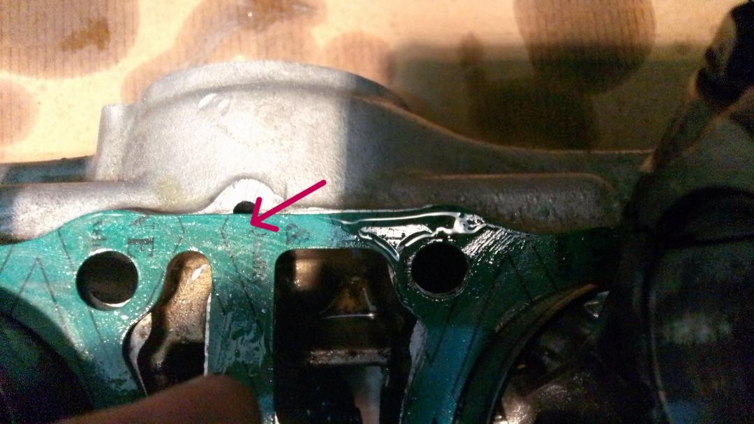

Not those big ones. there are 4 small O-rings around 4 studs for oil. They are the studs with a larger gap around them in your base gasket image

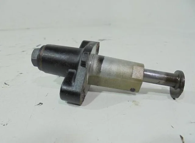

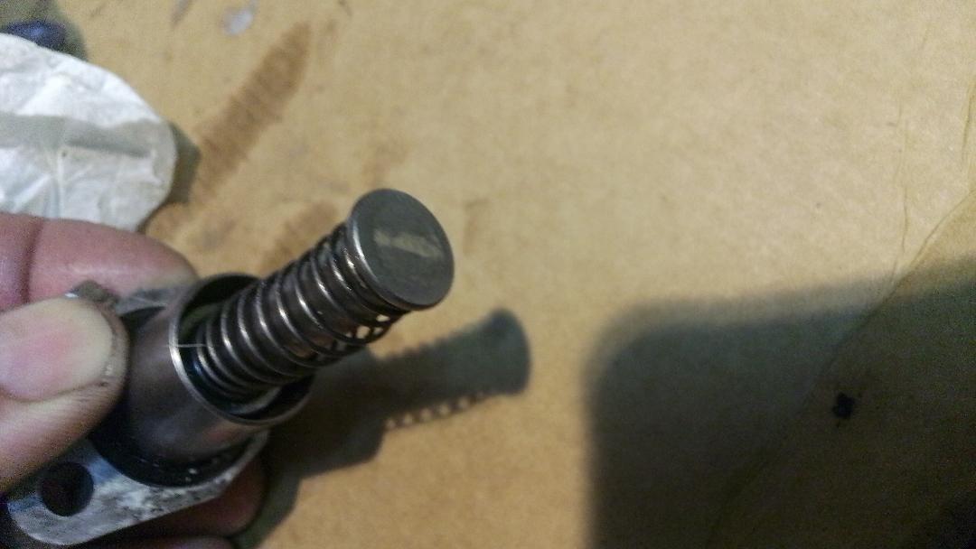

1 year 4 months ago - 1 year 4 months agoI'm thinking about getting one from a ZX10.correo escocés=33832 id de usuario=109¿Por casualidad estás usando un tensor de cadena de levas ZX10
The one I have mounted now is Chinese and I'm not convinced.

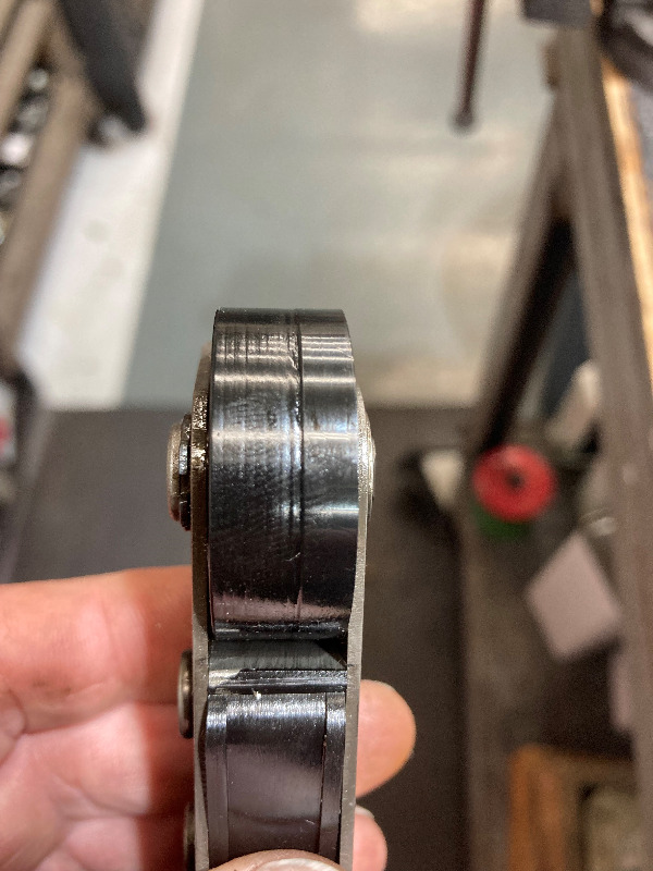

This is the CCT roller from my '79 project. A ZX10 CCT had been installed. The bike did sit for many years but the concern for the heavy spring in the ZX10 tensioner is clearly shown in the Chain Pattern on the roller; similar to yours. The asymmetry to the pattern on the roller would suggest that some slack somehow got the chain off-center, likely when it was parked for the last time.
Just pointing this out. You can arrive at your own conclusion.

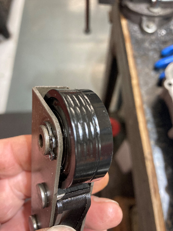

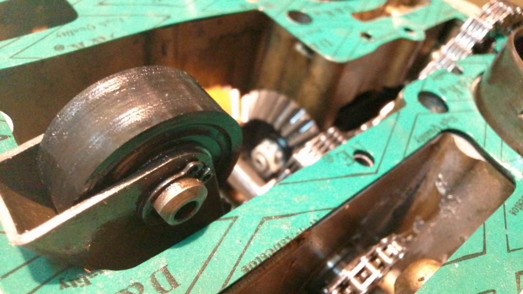

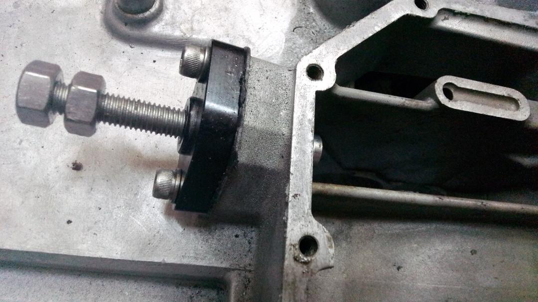

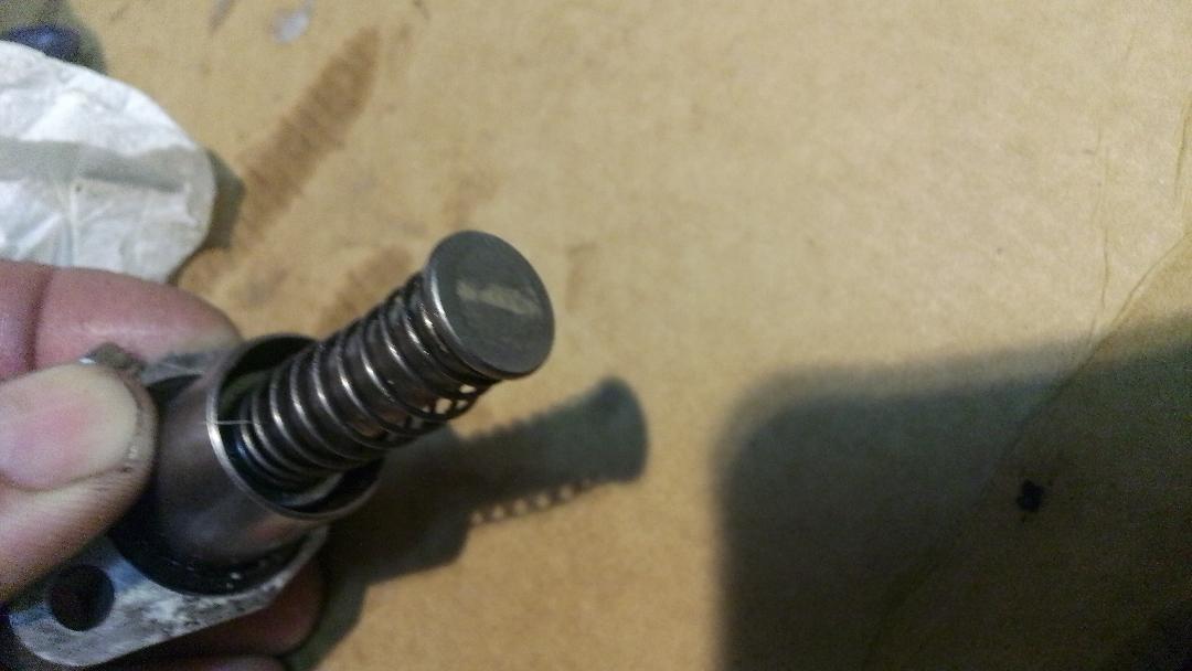

Christine came to me with her original chain tensioner.
As I told you I have mounted a tensioner of Chinese origin.
The base of the pusher is round unlike the original which is flat.
It has not run for more than two hours and this is what the tensioner wheel looks like.

Regarding the O-rings on the engine block studs, I have to replace them; the ones that were installed can no longer be reused.
I will buy a set tomorrow. I also have to cut out the water pump drain hole in the cardboard gasket, I'll make a notch with a cutter.
