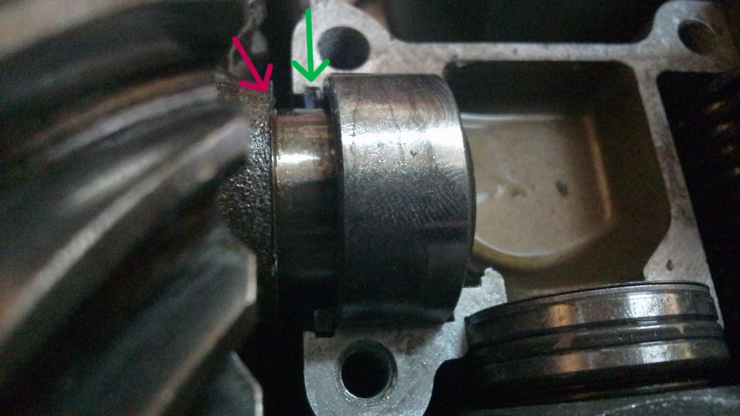

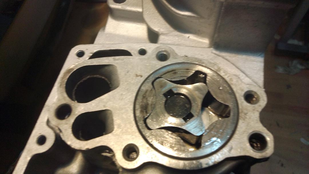

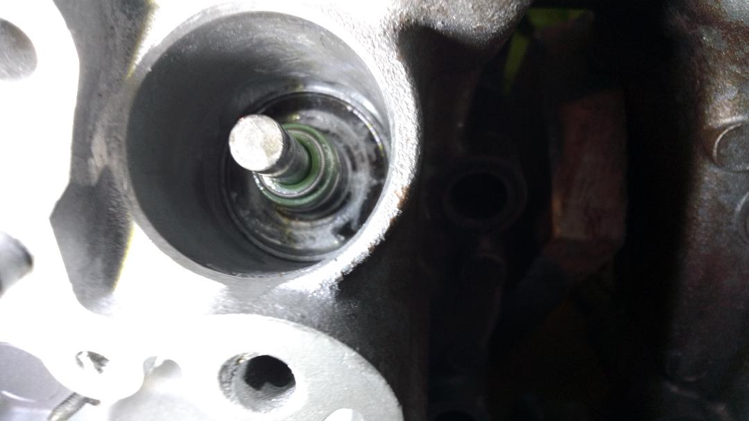

The red arrow shows signs of the shaft rubbing against the bearing as it is not in its correct housing.
The green arrow shows the locking ring in place.

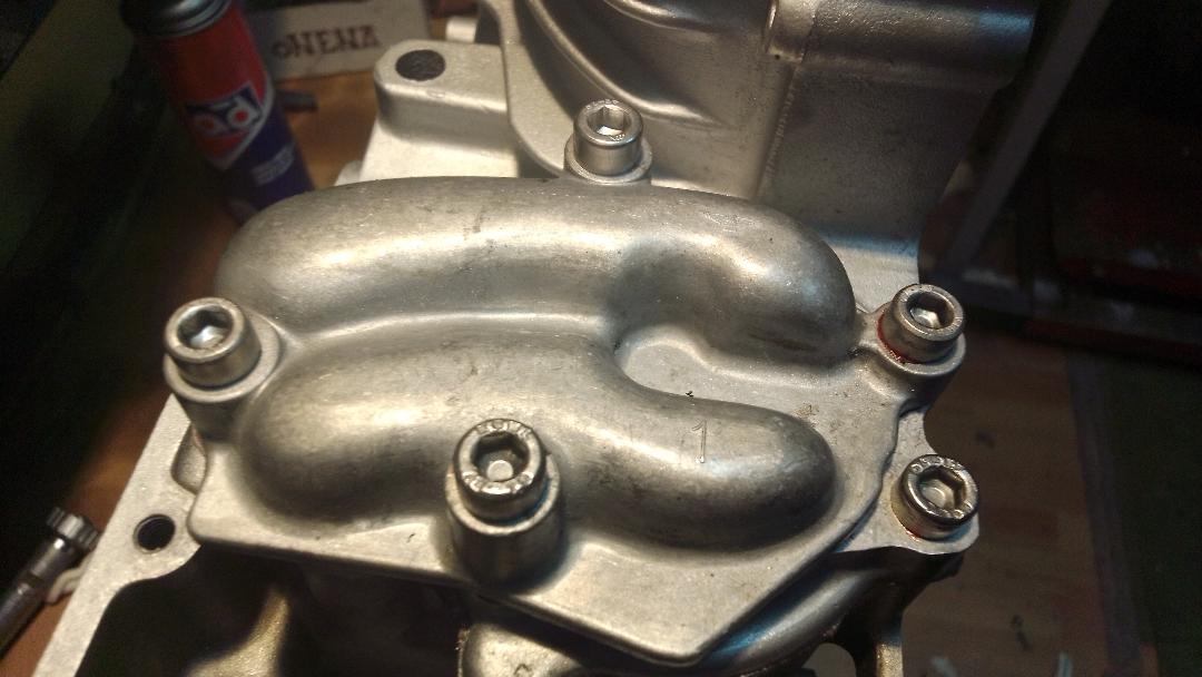

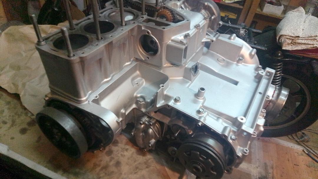

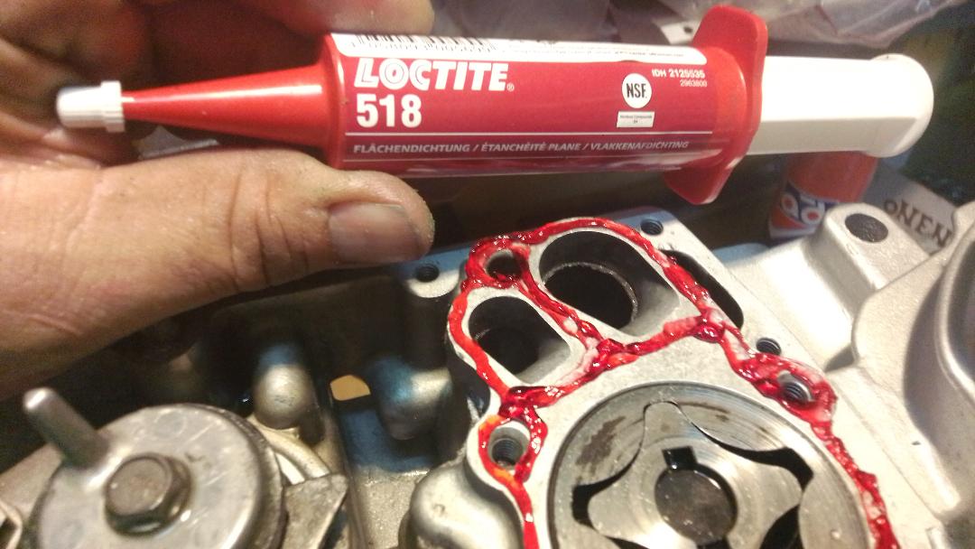

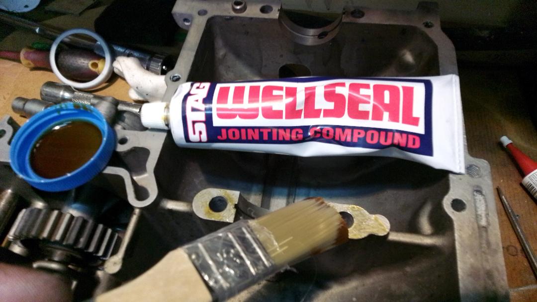

I disassembled, cleaned and reassembled the oil pump, used this gasket paste for the first time.
I tightened the screws and it was locked, I loosened one turn and it started to move with some effort, without stopping to turn I retightened the screws step by step to their torque and the pump shaft turned smoothly.

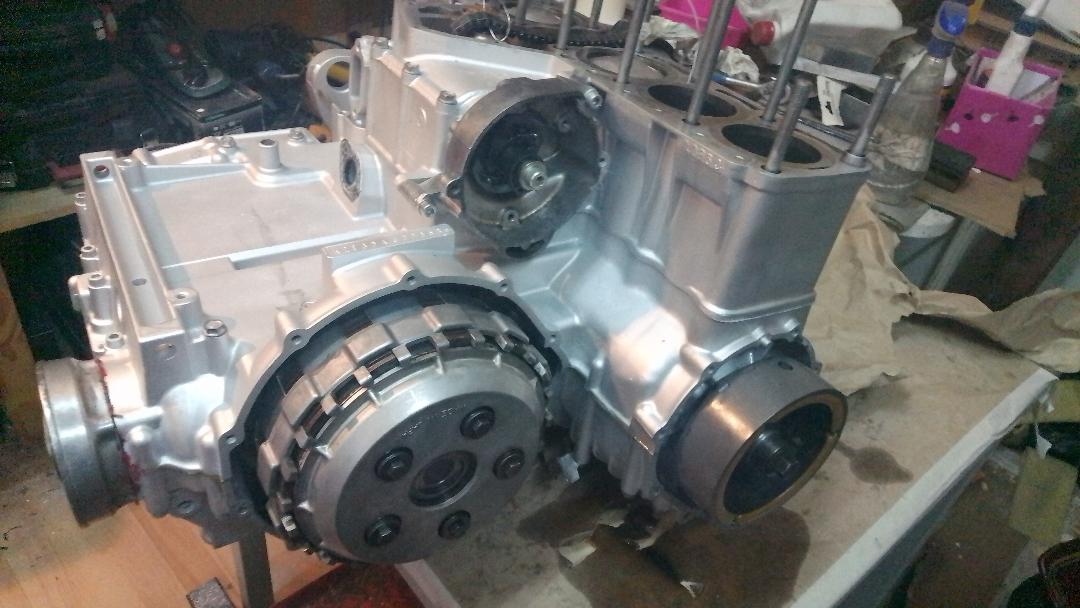

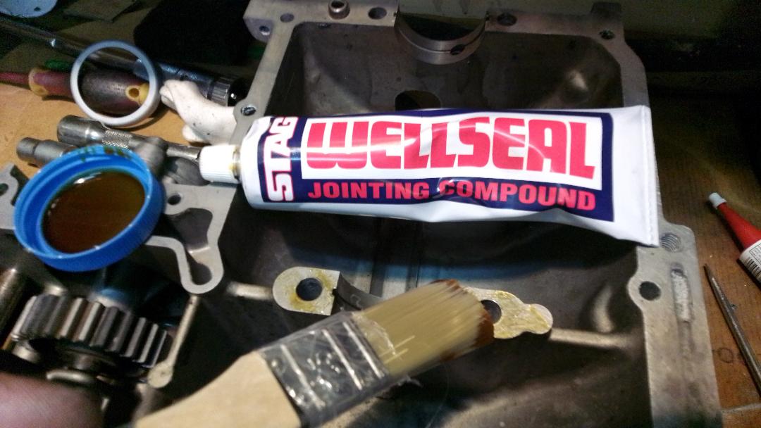

I used this gasket paste applied with a brush to seal the crankcase joint.
I already have the crankcase closed and the bolts tightened with their torque.

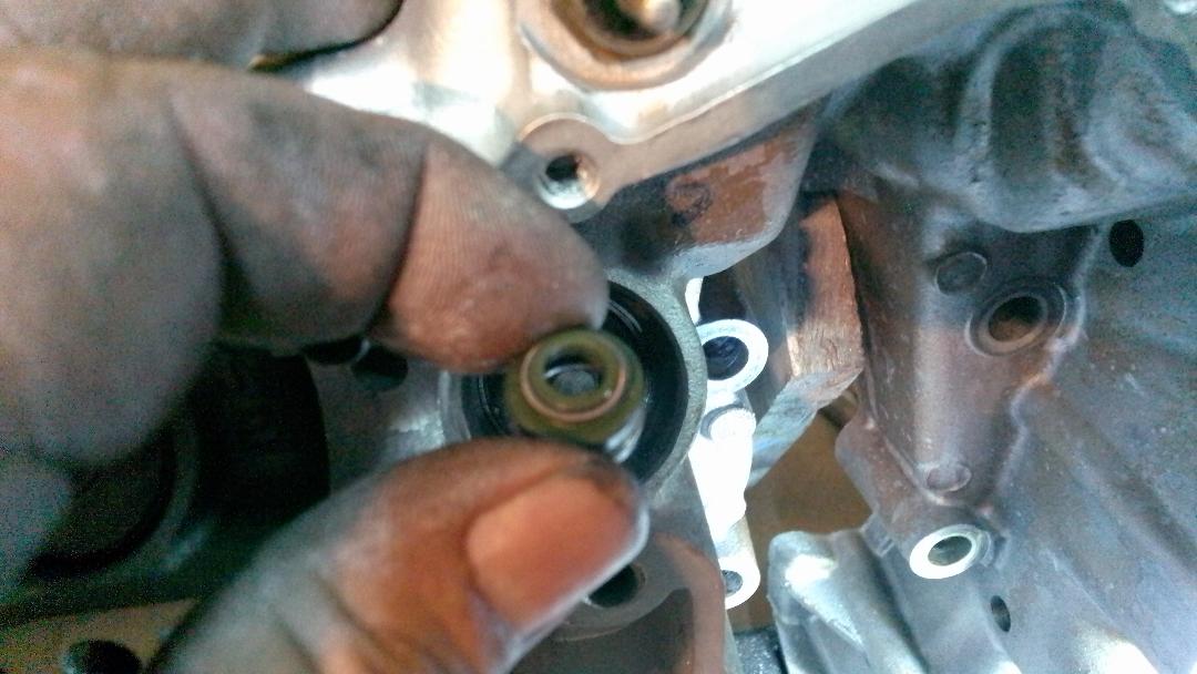

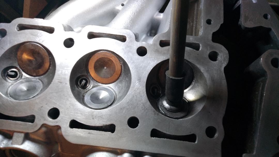

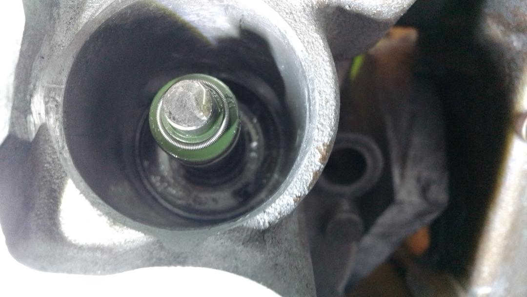

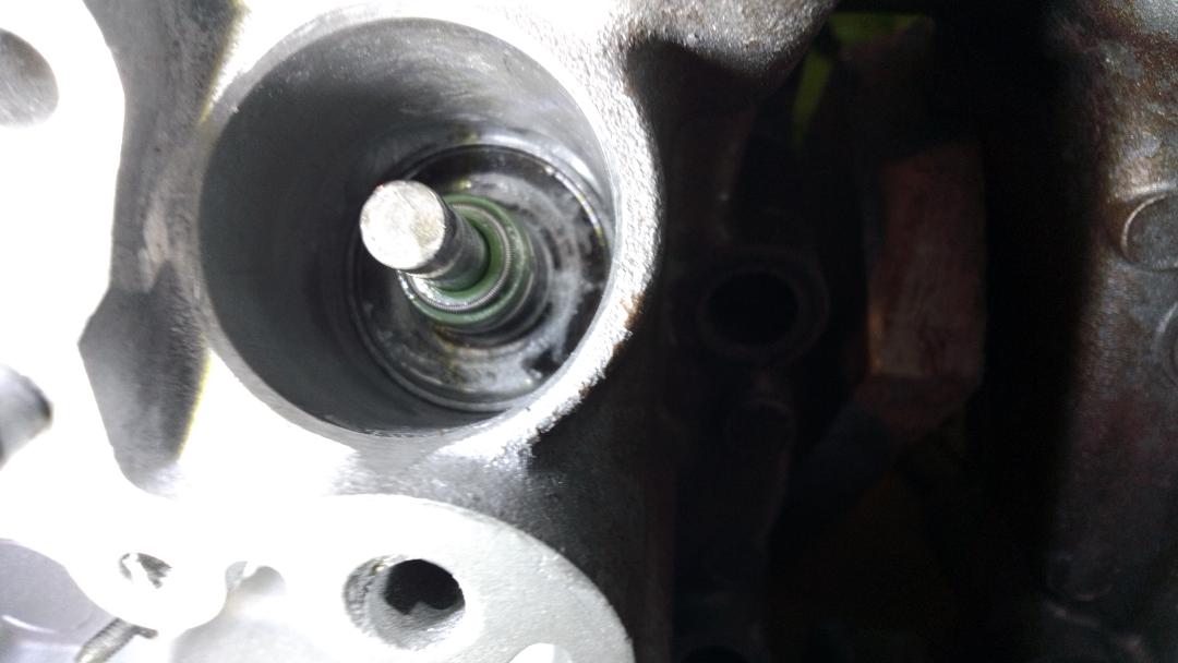

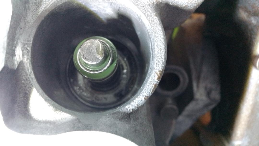

After three weeks dismantling and sorting through a beautiful BMW, I'm back with Christine. The next step was to grind the valve seats and fit Viton seals to the valve guides.
I'm going on vacation for three weeks, and when I get back, I'll mount the cylinder head on the engine block.
