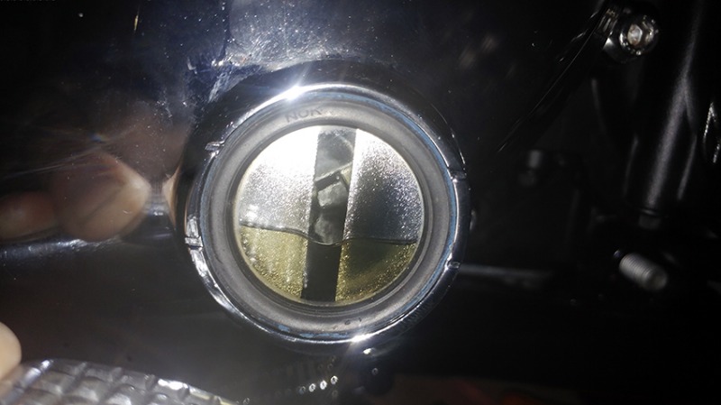

Posting because it's simply a milestone which for a long time felt like it will never happen. Have to add a bit more to compensate what the oil filter grabbed to soak his guts.
The water pump seals had been treated with Lucas engine assembly lubricant, so I am not afraid to crank the engine. But I will wait for the next time and a video making until I attach the radiator and fill the system with coolant.
