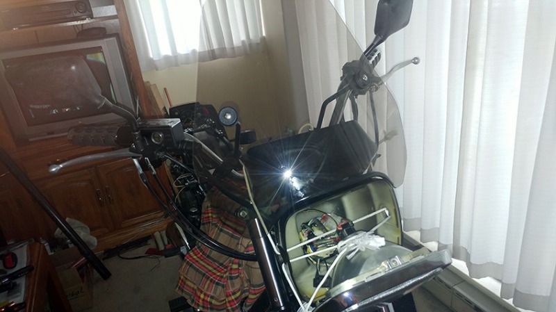

I've had this free acquired windshield sitting around for many months. I knew it will find it's purpose. I am going to shave off few inches from the top, and it will keep the bugs, stones, and the wind off my face. And it looks great!

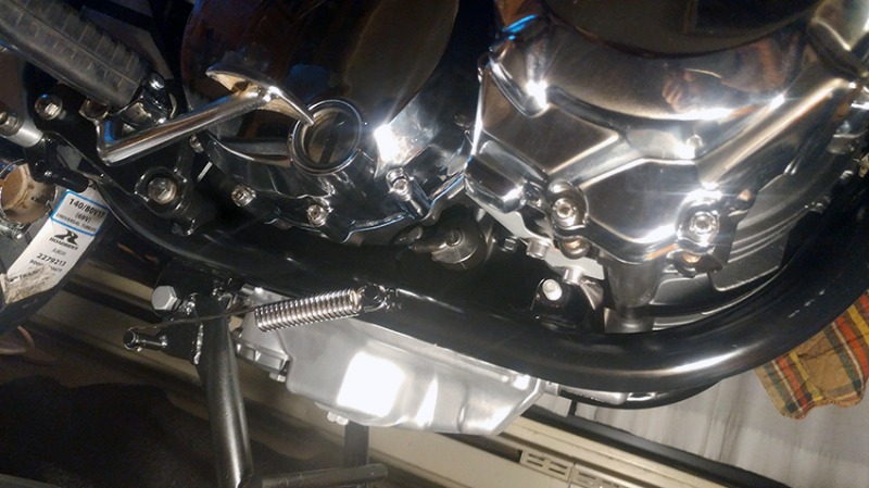

The oil pan installed, including the oil filter
The cover side - I used some liquid gasket, the top side just rubbed in engine oil. Tomorrow when it settles I will fill the engine with oil. Rotella T4 15-40.
Already planning on how the heck will I move the bike... It will be tricky. Has to be solid and safe. Any ideas?

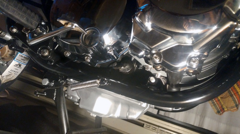

Oh, yeah. Can you spot the missing nut on the engine to frame mounting long bolt? I can't find what exactly it is. Looks like fine thread.
Any info on this?
Any info on this?
