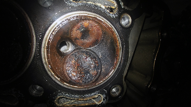

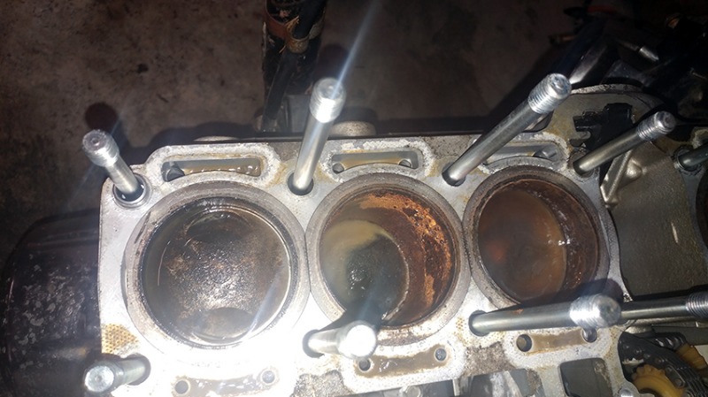

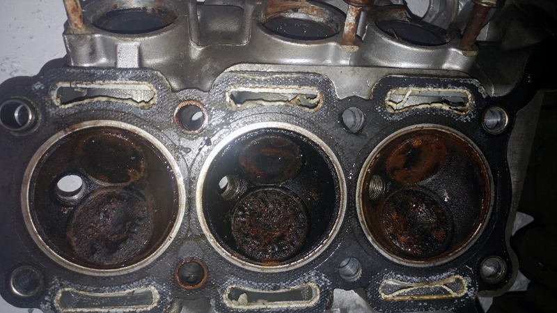

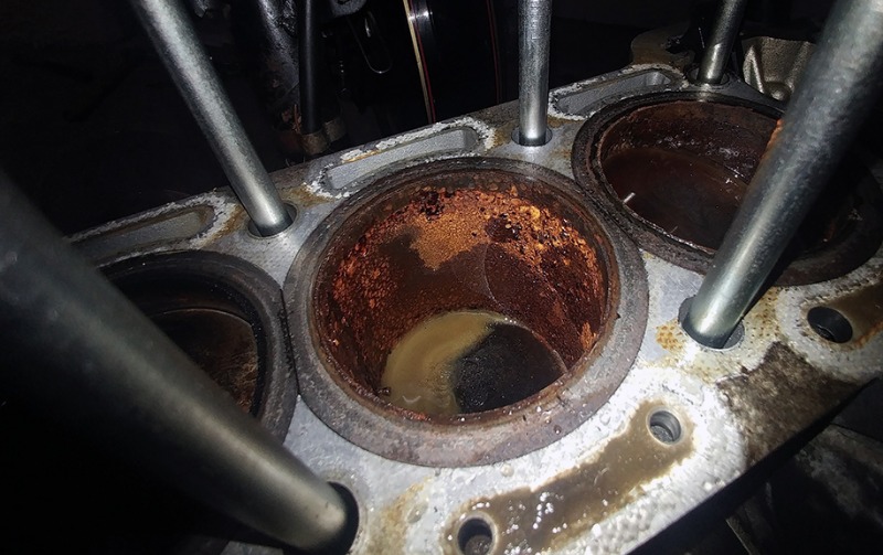

What you see inside the pistons is water.
