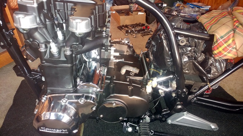

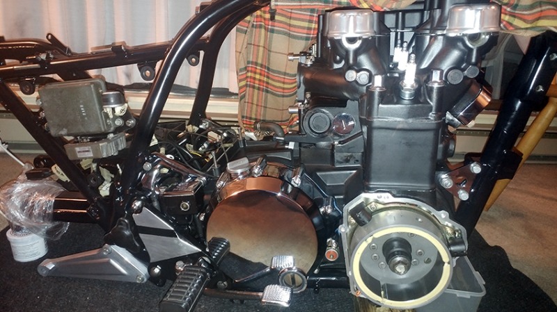

The current state of affairs. (the head cover is just sitting there loose to keep dust from the camshafts and things falling into the engine)
