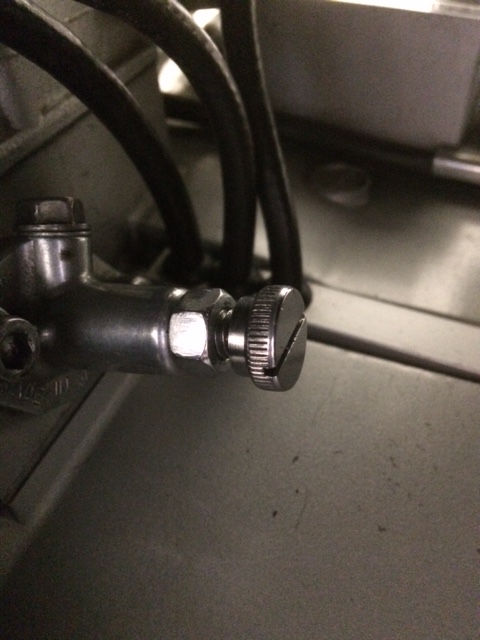

NEVER tighten the CCT with a wrench on the Bolt-Head !!!! My personal experience has always been to turn the BOLT in by hand !! Using a wrench on this bolt will most likely over-tighten the adjustment !

It is definitely a benefit if the CCT bolt and body have a "relaxed" fit - turns easily with fingers. I never did like "their" idea of having A "HEX-head" on the bolt end. Someone somewhere (if it hasn't already happened), is going to wrench that sucker in and .............That's how things get broken !
I did! Wit a wrench because it's hex and being tight really difficult to get that 'feeling'. So I was looking for mathematical reference point. I will experiment and find the right point. Would be very helpful to confirm my last conclusion - re: limiting movement rather than applying tension. I was going by the name, which in such case should be rather a limiter. That would certainly help knowing which goose I am chasing after. A limiter of chain movement under load. I hope I got it right this time.

And only because my mind is on Cuban Rum, Helicopters and bikinis.....not necessarily in that order.....and because I can't focus on work..... I found this nice knurled piece.
Kept my mind busy for 20 minutes and as I indicated earlier - no particular reason - just did it. So the only wrenching you need to do is to tighten the locking-nut !
