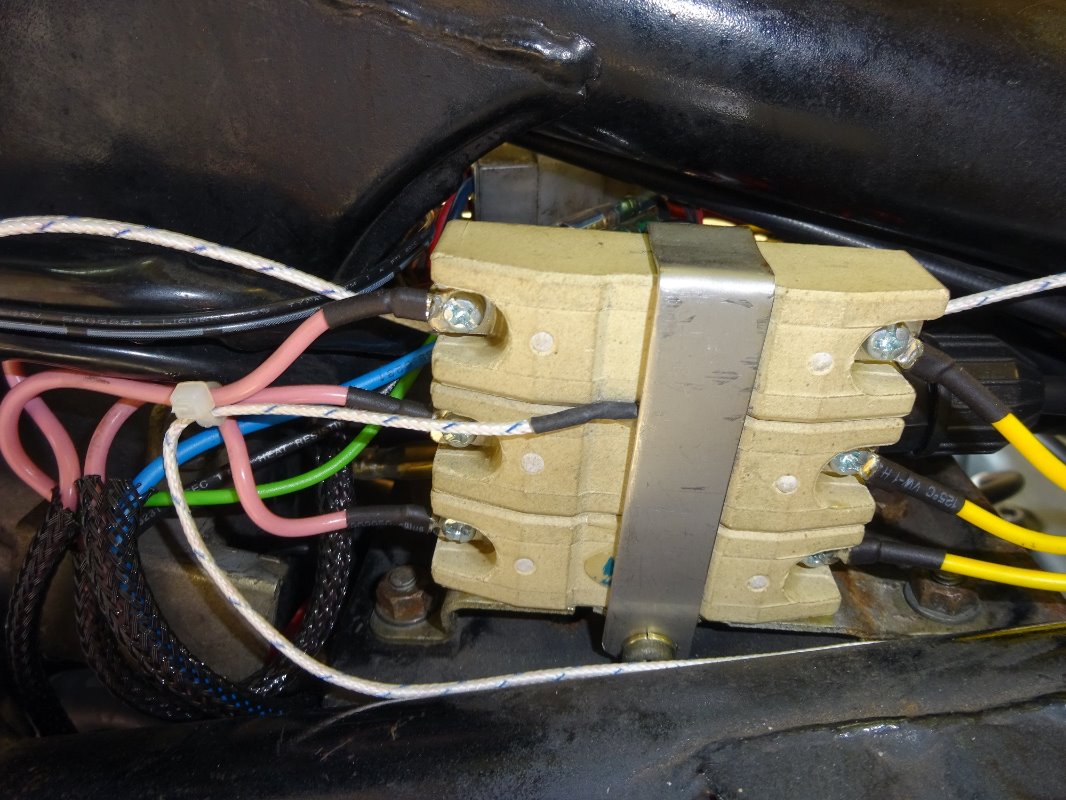

Just an update to my coil and ballast resistor upgrade. Out of interest, I have measured the operating temperatures of the new ballast resistors using a "k" type thermocouple and digital readout. I fitted the tip sensitive thermocouple behind the ballast resistor mounting bracket, wedged up against the ceramic resistors. See pic below:

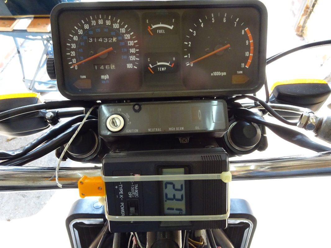

I fitted the digital readout to the handlebar clamp using tie wraps - the readout shows the ambient temp in the UK - yes - we're having a heatwave at present!

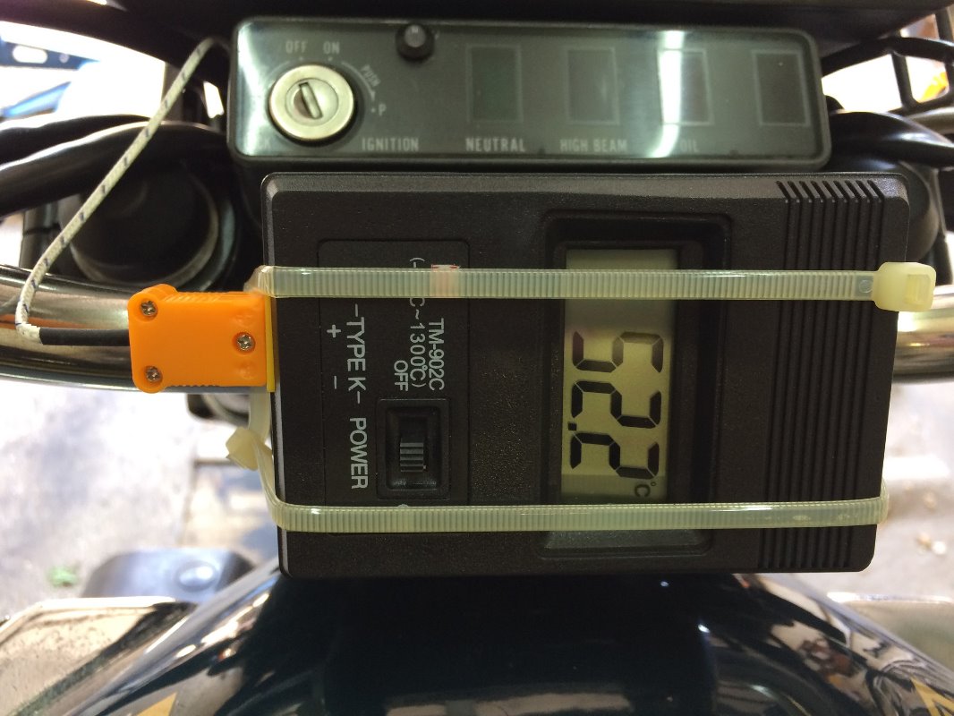

I rode the bike for about an hour, covering motorway (75-80 mph) and also congested city driving. On the motorway, the temperatures were generally around 32-34 deg C but increased significantly when stuck in traffic to over 50 deg C. Interestingly, the temperature also rises after switching off the engine when stopping. See below:
I can only conclude that the main source of heat is actually heat soak from the engine and not the current drawn by the ignition system? My calculations suggest that worst case current draw would equate to about 12 watts of heat to dissipate - probably lower when the engine is running as the current is switched off to initiate a spark - so maybe this is what I should have expected. Any other thoughts?
