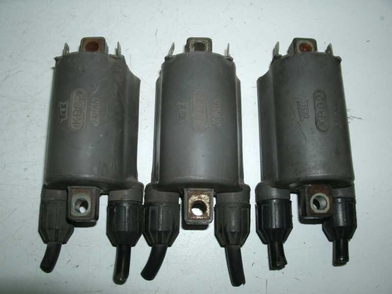

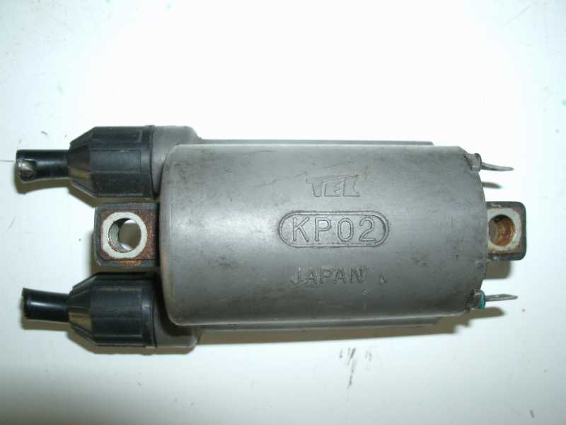

well theres a thing pete, i looked at it yesterday and found some aftermarket coils already fitted !!! they are not AW80 TEI coils but the strange thing is that the ballast resistor is still there and wirired in !!!
i am going to follow your advice and remove when my AW80,S arrive.

for anyone interested I have a set of 3 aftermarket coils. not AW82 but they work really well
happy to sell for £35.00 plus postage
