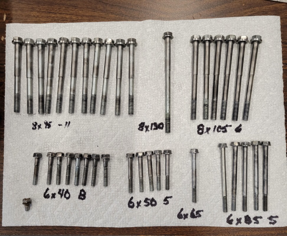

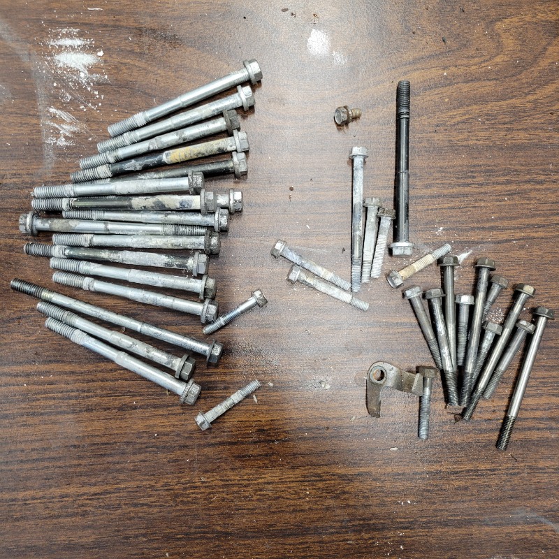

I've ordered a KLN110 cam chain and I'll shorten it to the required 72 links. There's a 3 week wait at the moment due to a back order at Kawasaki, so in the meantime, I have a pile of bolts to clean. What a mess. The case halves were joined with what looked like Permatex Form A Gasket (brownish in color and really thin), but the bolts are covered in what looks like a whitish sealant that I think is pipe dope. I'll wire wheel brush them on my 8" pedestal grinder and run a die nut up the threads and then decide if I'll treat them
Covered in what looks like pipe sealant. Too filthy to assemble with. So we clean.
3 hours later the lower crankcase half joint bolts are cleaned, and checked with a die nut.

Is a die nut the same as a thread chaser (nut)?
- Posts: 3300
1 year 11 months ago - 1 year 11 months agoYes they are. I prefer die nuts because if you need to clean a thread in situ you can drive the die nut with a socket and rachet or a combination wrench. When using dies, you are limited to using the supplied handle and as an example, if you had to chase a thread on one of the cylinder studs where adjacent studs are 4" away from each other, a die and handle would be a problem.Is a die nut the same as a thread chaser (nut)?
Dies and handle are more of a thread making tool used in a shop to cut threads . The dies are circular and have a split in them. You can use a die to cut an oversize thread by opening up the split in the die with the middle screw in the handle before tightening down the outer 2 screws. Most people are unaware of this feature and simply, install the die in the handle and tighten down all 3 screws.
