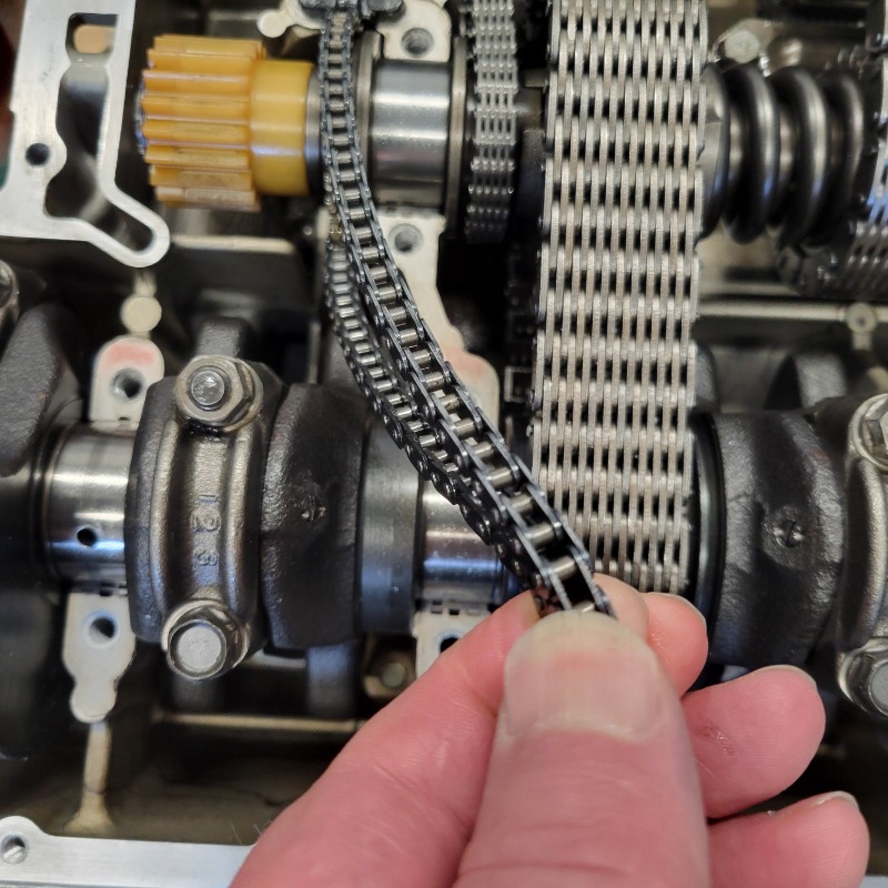

I've spent the last couple of days tapping out the casing half joint bolt holes, while staring at the new primary, secondary and camshaft chains, thinking once I add the new oil pump drive gear, I'm just about ready to reassemble the engine. then I look at the tiny chain that drives the water pump drive shaft and wonder if I shouldn't replace it for peace of mind. So I grab the chain and flex it sideways to try and determine the wear of the chain. Roller chains when new might flex 10-15 degrees to each side. this one I can bend almost 45 degrees like Bobby Hull's curved blade hockey stick. ( now that might give you a hint to my age). There's no spec in the manual for measuring the chain for wear, so it's a judgement call. Yup, replace the chain is the thinking because if the chain breaks, I'll be on the side of the road which is something a mechanic would NEVER admit to and when it breaks, I'm sure it would get snarled up in the new oil pump drive gear. So not worth taking a chance.
I measured up all the critical measurements for a roller chain and check the roller chain dimension charts. Everything about this chain points to a #25 standard roller chain Except the roller diameter. I measured .125" for the roller diameter but the #25 roller chain has a .130" diameter roller, no exceptions. So what are the chances that the rollers on this chain have worn down .005" ?? This is something I've never measured in the past on a roller chain. Every chain I've changed out was a standard chain and I never had to actually measure a chain to figure out what type of chain it was.
So I plan to buy 2 ft of the #25 chain ($20 CDN) and check it for fit on the drive sprocket on the secondary shaft and if it fits, great. If not, the search is on.
Too much flex for my liking.
