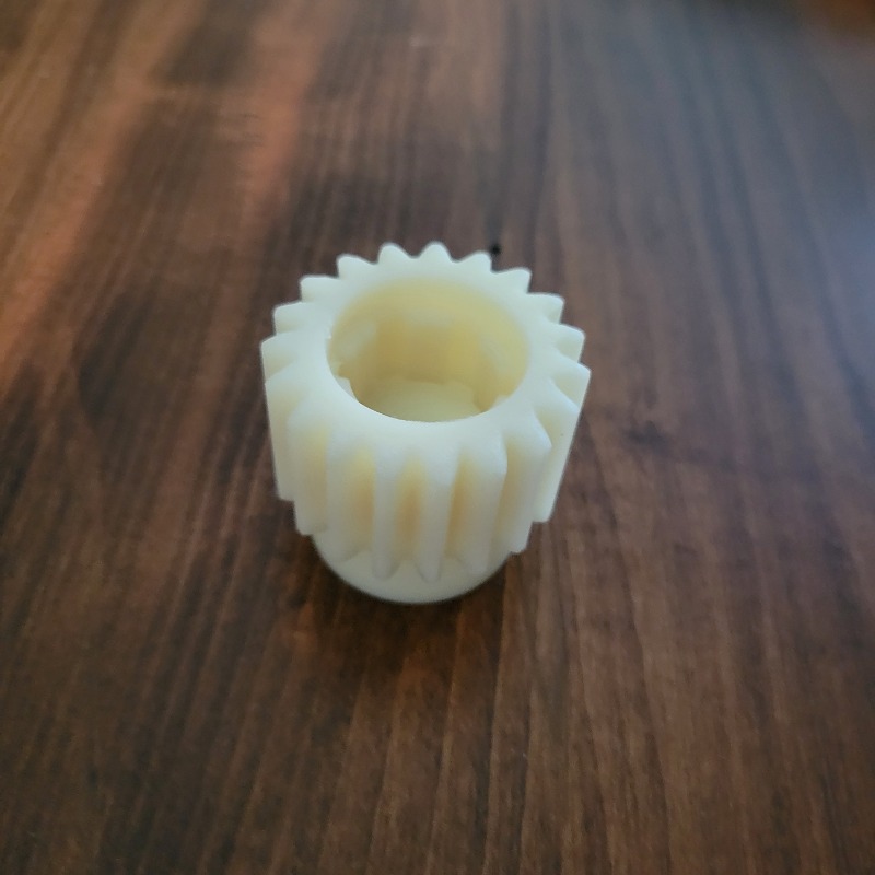

Christmas came early thanks to Helmut at
www.Z1300.de
. I recieved the new \Oil Pump Drive Gear. Looking forward to installing it.

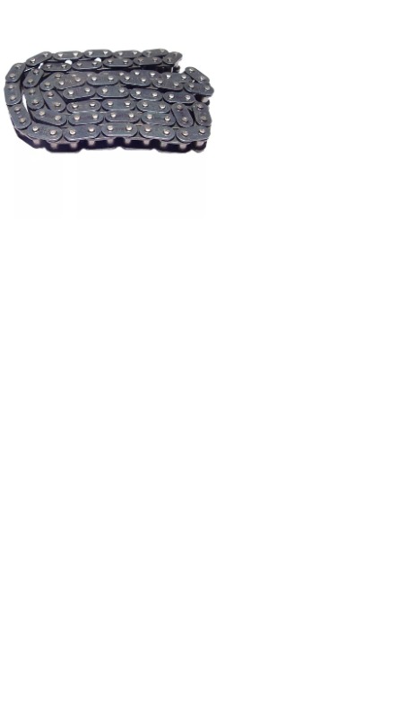

I also think I found a source for the water pump drive chain. I've sent the seller a message to confirm the sizing of this chain.
