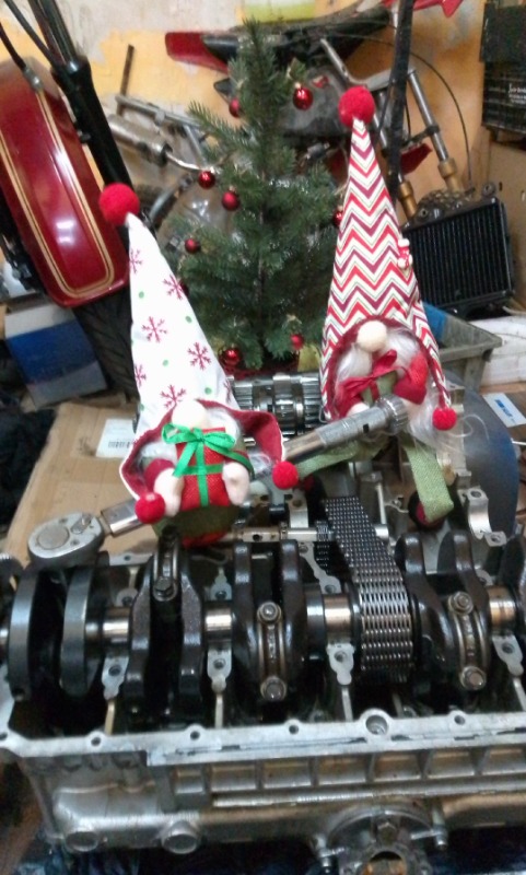

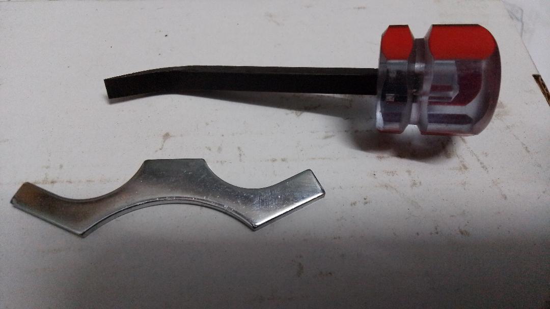

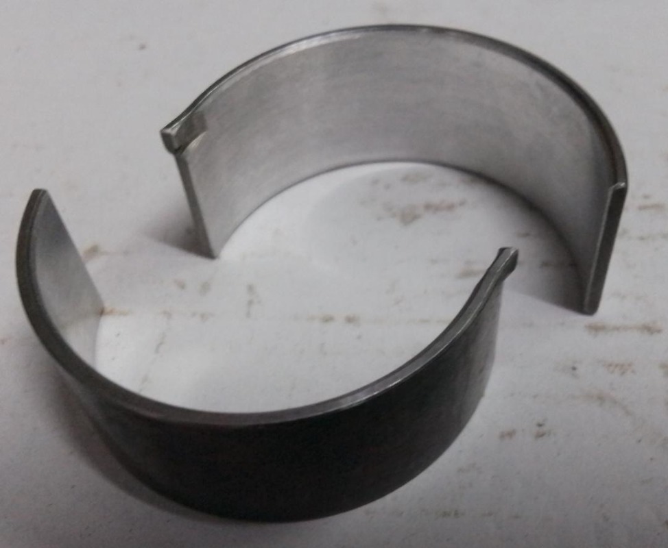

Good.
I just received more pieces from the Germany page.
The two exhaust valves that I have already delivered to the workshop that rebuilds my cylinder head.
The tool to remove the shims.
And the connecting rod bearing that I was missing to replace the piece of sheet metal from the cookie tin that they had used in its place.
I'm thinking about starting to assemble the motorcycle parts on Christmas night to take advantage of the magic of the Christmas spirit and not be alone in facing such a challenge.

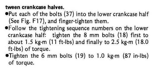

By the way, do you have in mind the tightening torque for the connecting rods and crankcase bolts?
My level of English is very basic and I get lost reading the maintenance book if I deviate from the photos shown.
Merry christmas¡¡
  • Posts: 3289
  • Thanks: 1222
Re: THE MOMENT OF TRUE.
#31923
Connecting rod bolts torque to 25 LB/ft  (3.5 Kg- m) page 112 in the manual
Crankcase bolts torque to
from page 101
See page 100 for bolt pattern  Figure 17
