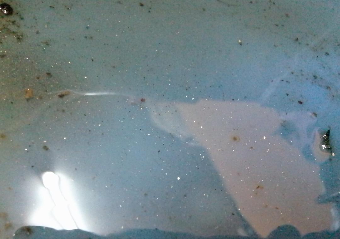

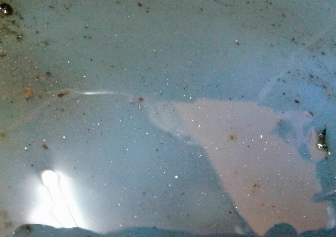

I have cleaned the oil pan, all its ducts as well.
My cleaning bucket is full of gold flakes, there are people in the Yukon who would kill to have a pan like that on their gold concession.

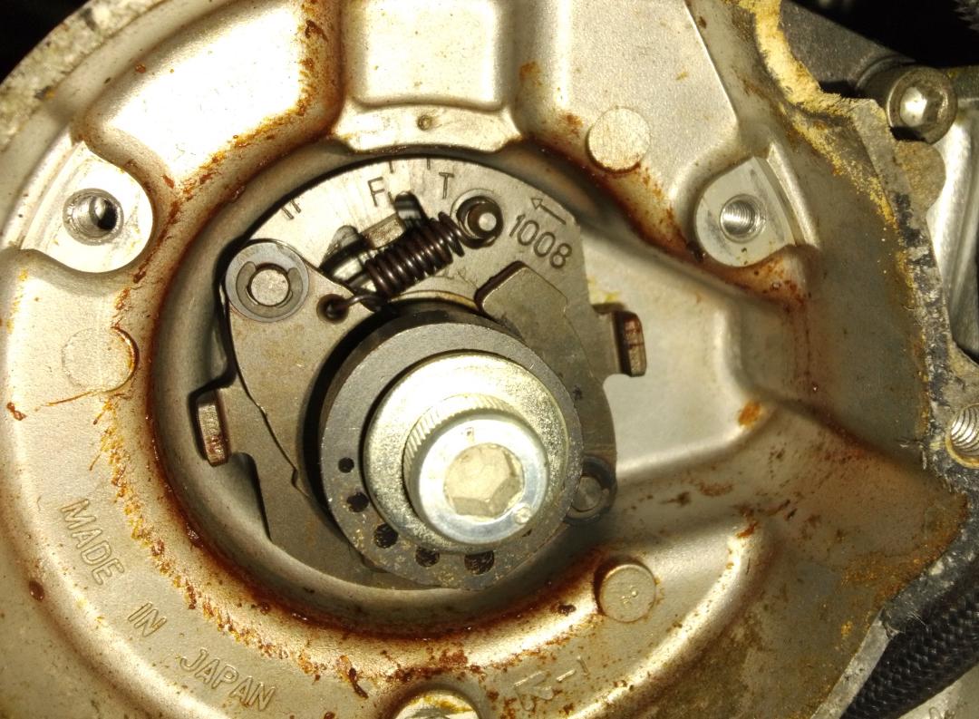

I have also adjusted the timing point, this weekend I will start closing the engine case.

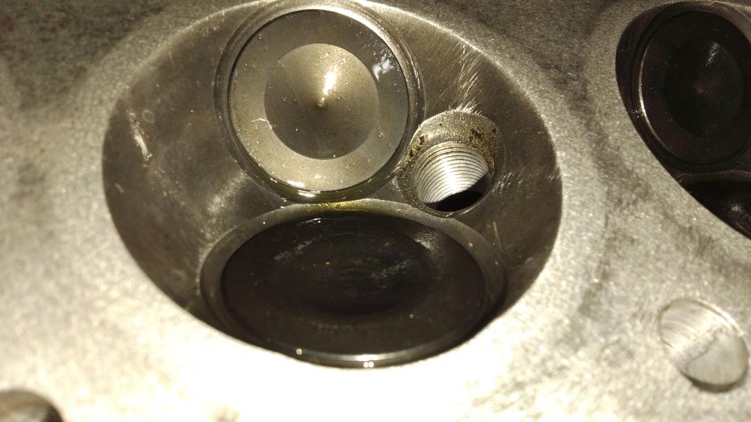

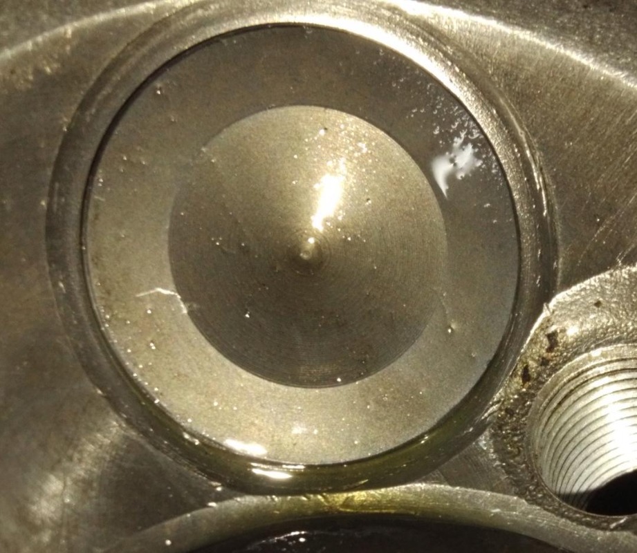

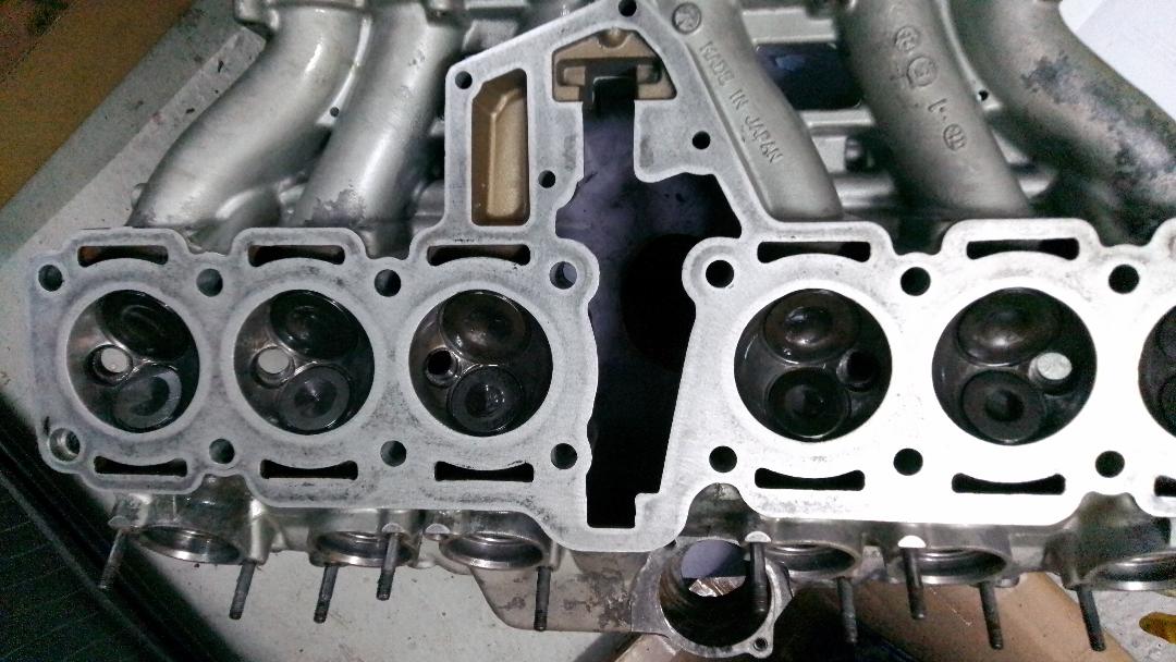

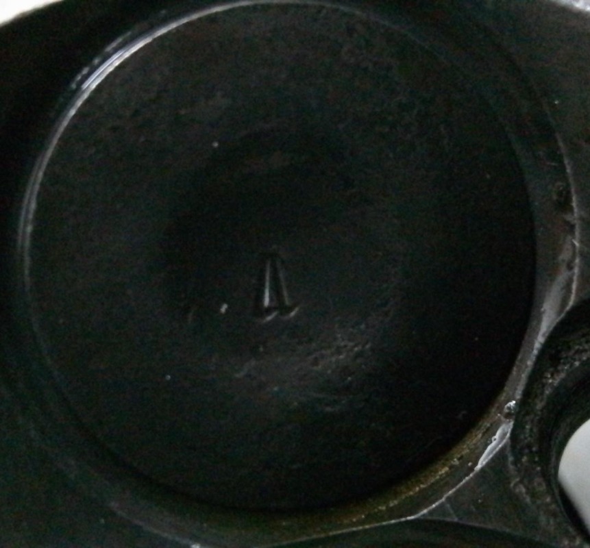

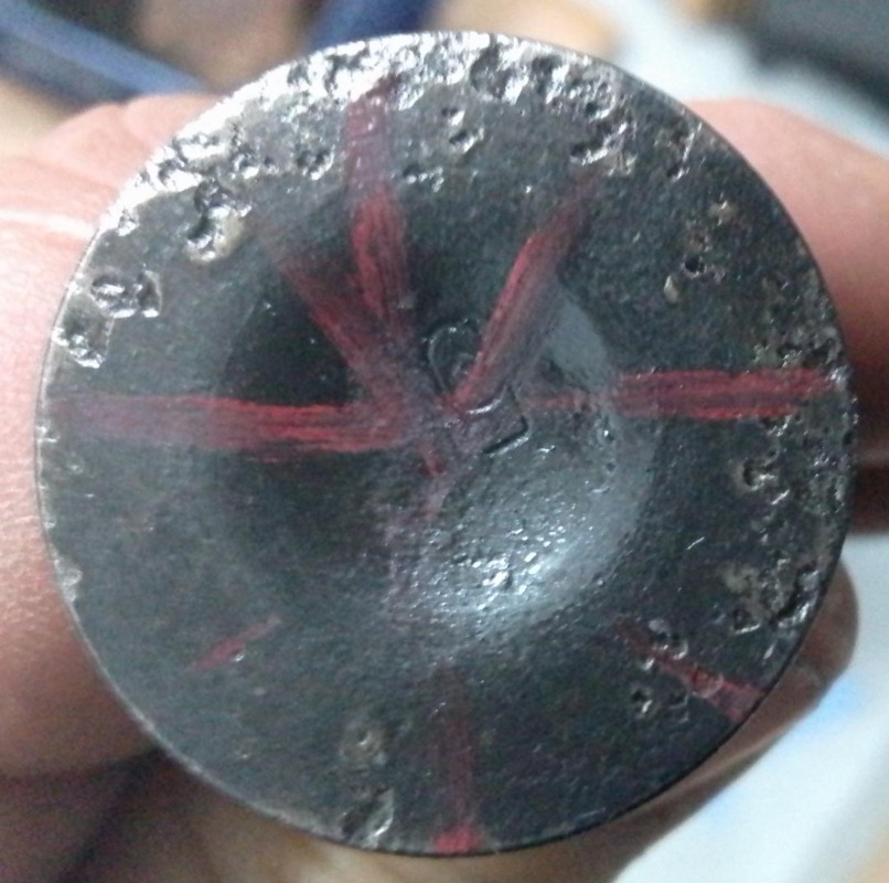

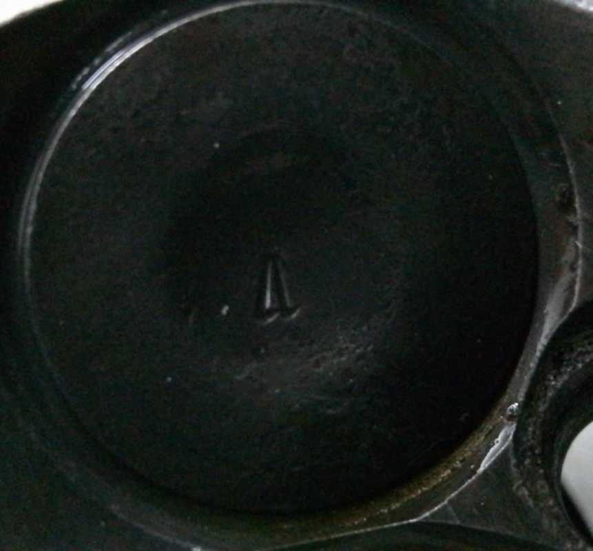

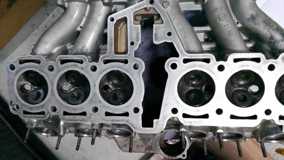

Today I went to the workshop to pick up the repaired engine head.
Its cost was 200 euros of work added to the 100 that the two new exhaust valves cost me, the total was about 300 euros.
This is how the valves that have been replaced were pitted.
Once assembled they look good.
The new valve is somewhat different than the original one.
This weekend I will patiently assemble the engine.
