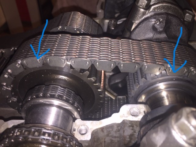

As for the timing mark on the crankshaft, I would suggest you get the secondary shaft in position and then count forward 7 full links and you should be able to see the mark on the crankshaft and confirm it. Then if necessary re-punch the mark or put a score line on the crankshaft so you know which tooth to use for alignment.
Looks like you made a good decision to replace the primary and secondary chains. I am surprised that they needed to be done. Maybe the previous owner used cheap oil. Some of us here are partial to Shell Rotella T6 15W40 . It's actually a diesel motor oil but it has the MA and MA2 ratings for motorcycles. The zinc additive they put in it for the heavy duty diesel engines is excellent for wear resistance. The MA and MA2 rating for motorcycles is a rating to identify oils rated for use in engines that also have clutches so these oils will cooperate with the clutch pack regarding shifting and slipping.
I counted seven links back from the mark on the output shaft and couldn't see the mark on the crankshaft.
This motor has already been disassembled, the two axles may not have been synchronized when it was assembled.
Starting from aligning the timing mark in "T" would it be possible to find out where the crankshaft mark is?

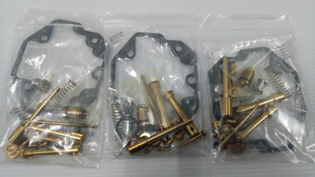

A month ago I ordered the Mikuni carburetor repair kit.
Today it arrived directly from Taiwan.
daminedingmoto.com/3-x-carburetor-carb-r...-kz1300-a1-a2-a3-b2/
We continue completing the puzzle.

I spent the night searching the forum for some clue on how to align the crankshaft with the primary shaft since I have only been able to find the mark of the primary shaft, I cannot find the mark of the crankshaft.
I found this photo in an old thread.
Can anyone confirm if those are the marks I should follow?
