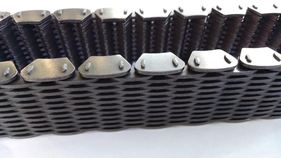

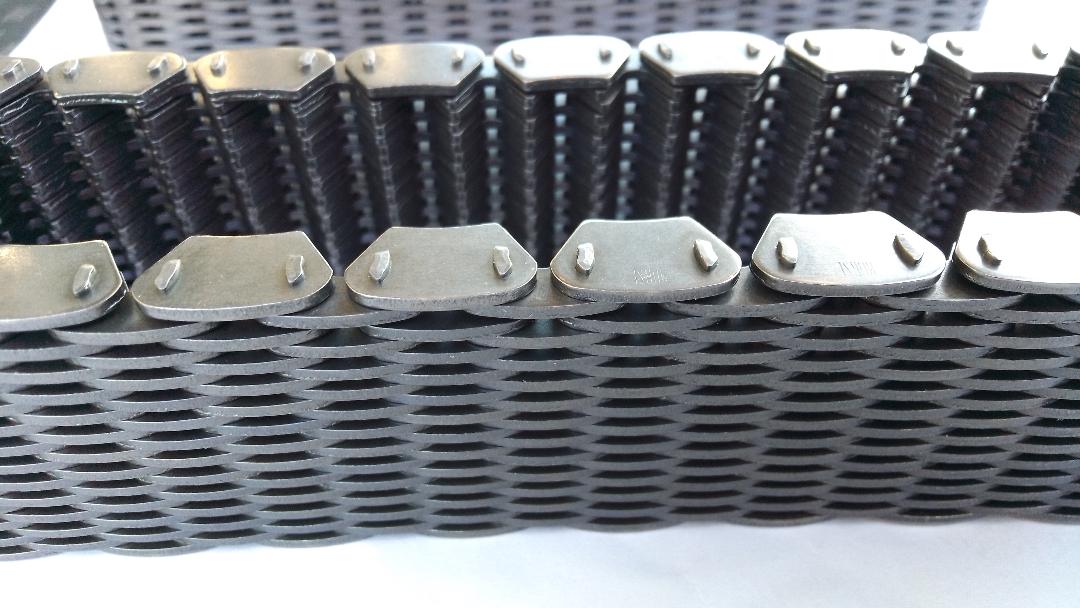

Today I received the MCG chains.
They have been really fast, on Monday I transferred the amount, on Tuesday the order went out and it arrived in a couple of days, crossing two countries.
Saturday afternoon I will start assembling the engine.

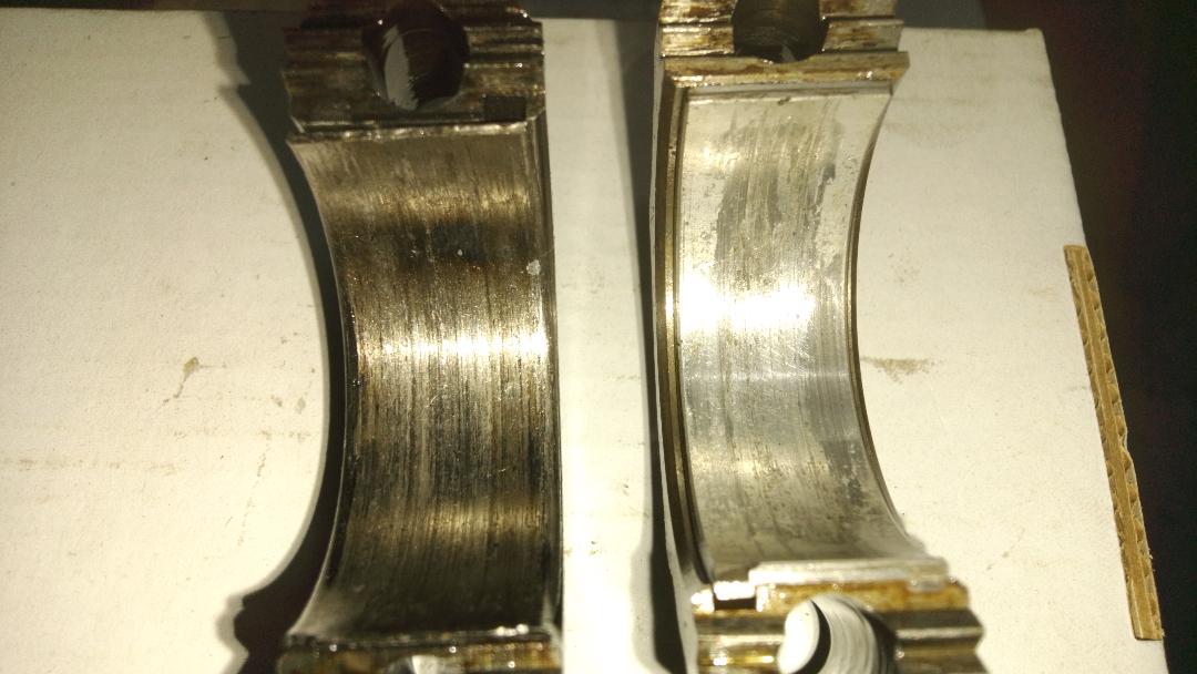

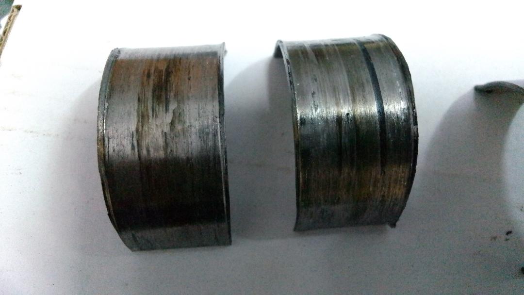

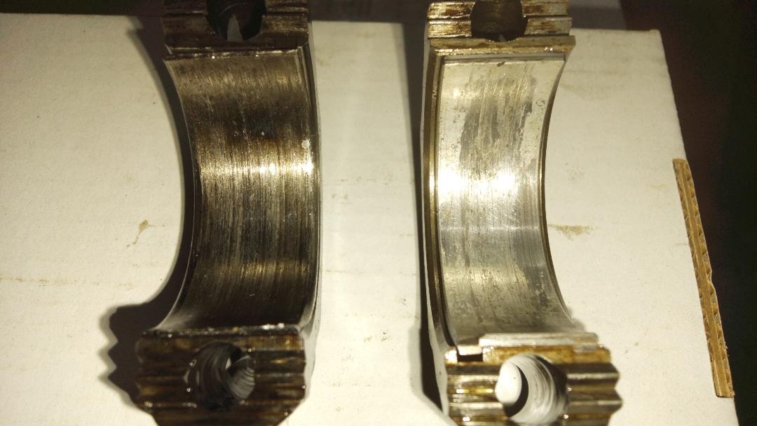

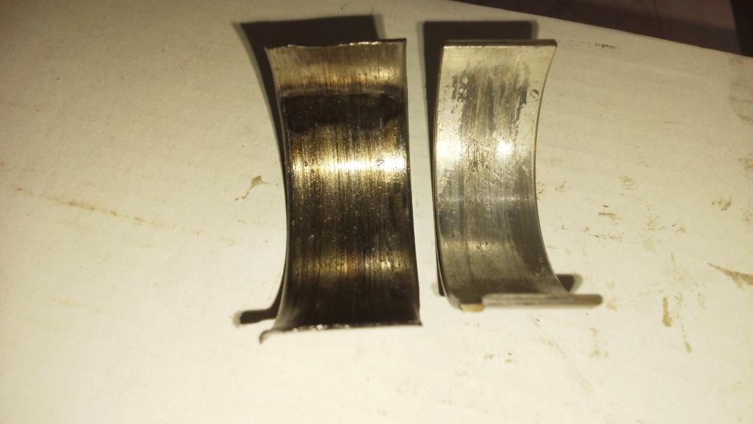

The bad news continues.

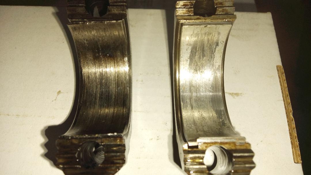

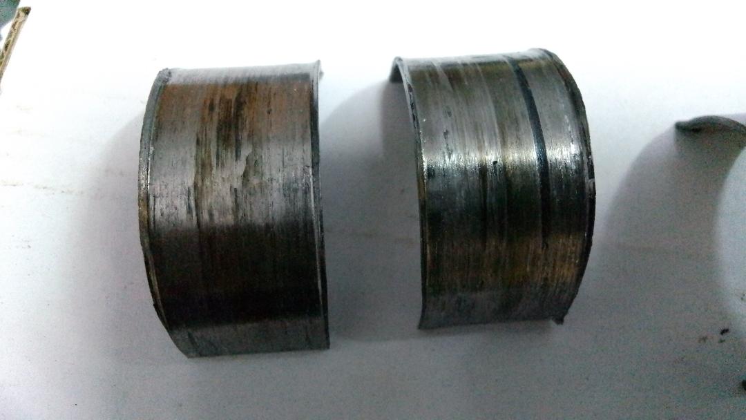

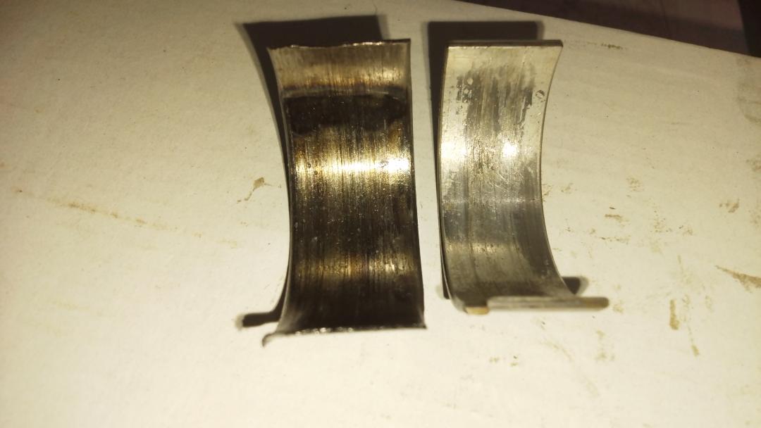

Today I removed the connecting rods from the crankshaft and I found the unpleasant surprise that the connecting rod of cylinder 5, the one that had no compression, did not have the original bearings installed, instead I had installed oversized iron ones.
On the right the original.
Not-original connecting rod bearing installed.
When searching the MCG PARTS www.z1300.de/ catalog I find two references for the same price, some are "brown" and others are "black."
Can anyone explain to me the difference between them?
Pair bearing shells for connecting rod, black. Price per pair 52.90 euros.
Artikelnummer: MCG 920281050
Pair bearing shells for connecting rod, brown. Price per pair 52.90 euros.
Artikelnummer: MCG 920281051

Re: THE MOMENT OF TRUE.
2 years 10 months ago
The colors relate to the journal sizes The black or brown fit different journal sizes.
This is covered in the Service Manual on page 187

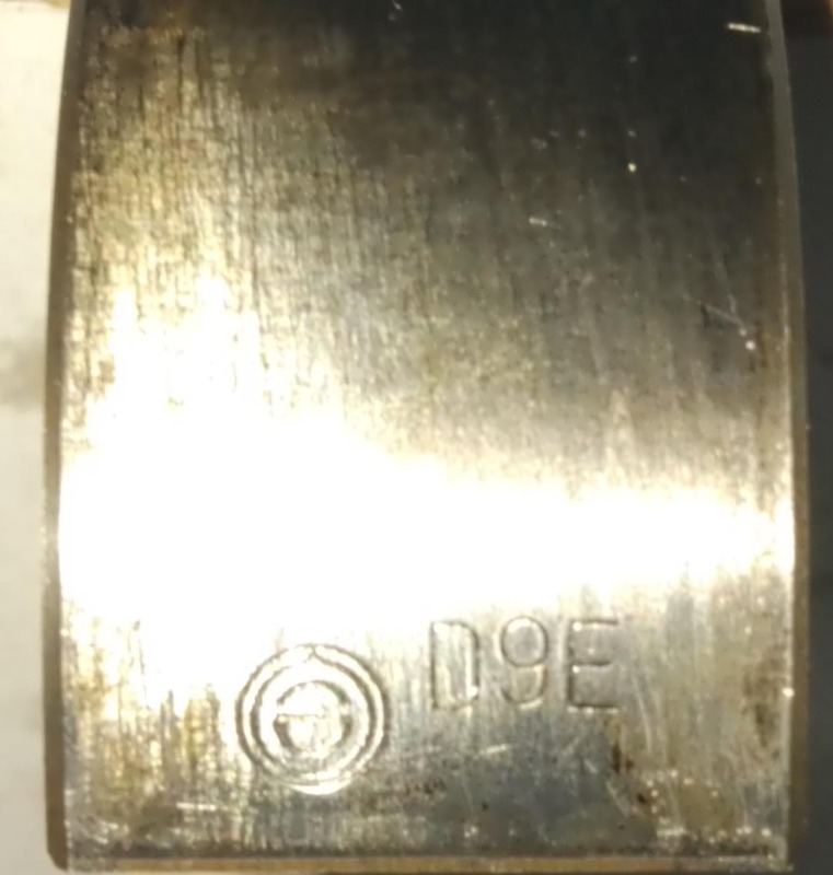

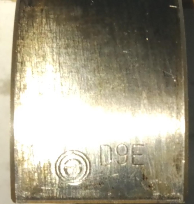

It is an engine rebuilt years ago with non-original parts.
I have removed three connecting rod bearings and this number appears on all of them.
D9E
I don't know the manufacturer.
D9E
