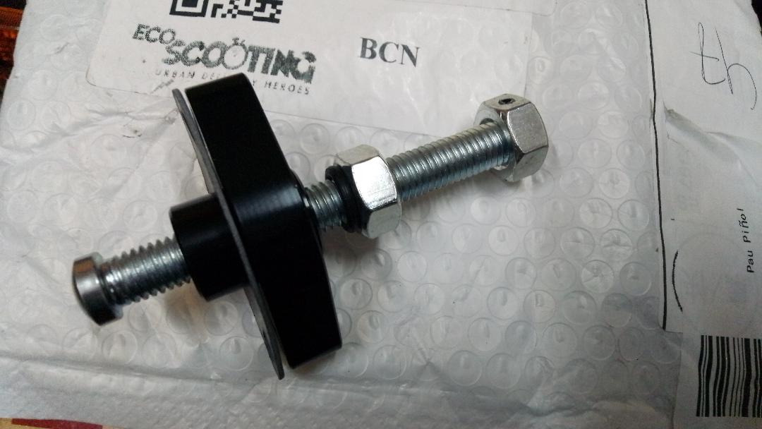

I return to the thread after a few weeks waiting for the distribution chain tensioner purchased on EBAY, it has finally arrived!
After assembling it and ensuring the chain tension manually, I continued turning the crankshaft and I noticed some slack in the chain connecting it to the secondary shaft. Using the endoscopic camera I recorded the movement of the chain.
My question is this:
Is this normal slack or is the chain stretched?
Does it have to be replaced or can it be adjusted somehow without removing the engine?
Thanks for the answers.
youtube.com/shorts/lJfdgwjJ8ww
youtube.com/shorts/rlkPUl2TglQ

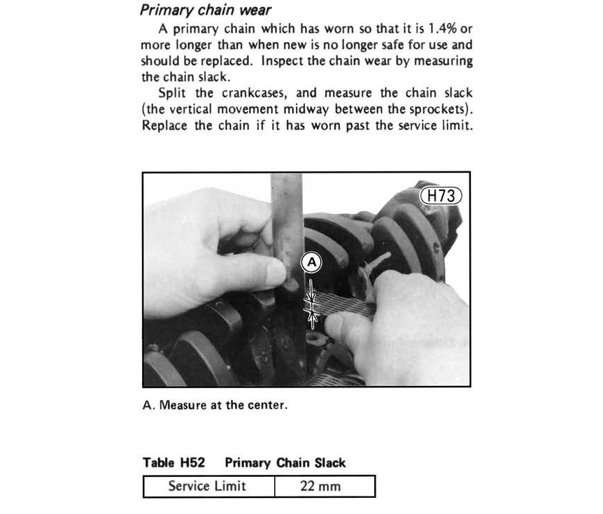

My question is directed at the tension that the chain that transmits the movement of the crankshaft to the primary shaft must have. I have noticed some slack.
Re: THE MOMENT OF TRUE.
Ahhhhh. The challenges of writing in one language and using a translator software program to interpret. Now I understand what your concern was.
This is right from page 189 of the Service Manual
You can measure this without splitting the engine with a little bit of thinking. I suspect that if the engine is under 100,000 Km and has had regular oil changes, the chain is fine.
