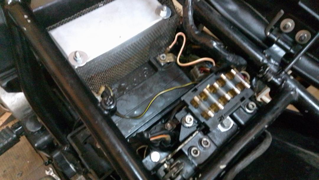

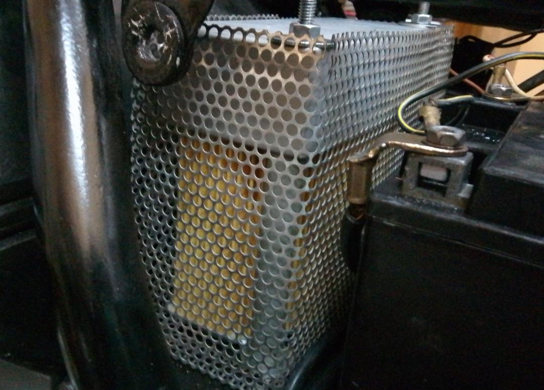

Given the impossibility of finding an Airbox in good condition and at a reasonable price, I have decided to build one.
I took a holey mesh from a used tractor air filter, folded it into a box to hold the original filter, and put a lid on it while waiting to find a piece of sheet metal to make the toolbox.
Yes, I know, my jobs are more in the "Pakistani truck" category than that of an official dealership mechanic but they really are effective.
To be continue...

Necessity is the mother of invention.
Well done! I’m eager to see this air box when finished.
How are your lips now? Perhaps consider the purchase of a small compressor for blowing passages clear -
it would be safer and more effective!
