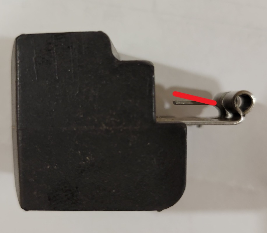

There are 2 reasons for carburetor flooding on these carbs-
1. The Nitrophyl floats (the stock black plastic floats) will eventually get saturated with gasoline and they will sink. When they do sink or start to sink most people will adjust the tang on the float to shut off the fuel at the right height. It's critical that the tang that actuates the float needle be at a right angle to the float needle and NOT try to shut off the needle by hitting it on an angle. If the tang tries to close the needle on an angle, It is possible for the needle to bind in the needle seat and not fully close. If you have to bend the tang on an angle to get your float level, then your float is saturated and you need to replace the float.

This is a float with a tang correctly shaped so that it closes the needle perpendicular to the needle
If your float tang has to be bent like the red line, then your float is saturated and needs to be replaced. if the tang is in this position, as it tries to close the needle, it pushes the needle on an angle and the needle will stick in the needle seat and not close properly.

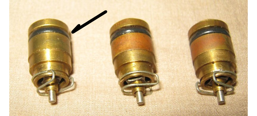

2 years 11 months ago - 2 years 4 days agoThis is the needle seat o ring that most people miss when rebuilding the BSW32 carbs. It seals the needle seat in the carburetor body. If it leaks, fuel will bypass around the seal and carburetor flooding will occur.
this o ring is 7.5mm inside diameter and 1.5mm thick. My advice is to replace it with a Viton75 o ring of that dimension. Ethanol will not affect Viton75. The original o ring was Buna-N Nitrile and back in the 1980's, Ethanol was not a component of gasoline.
