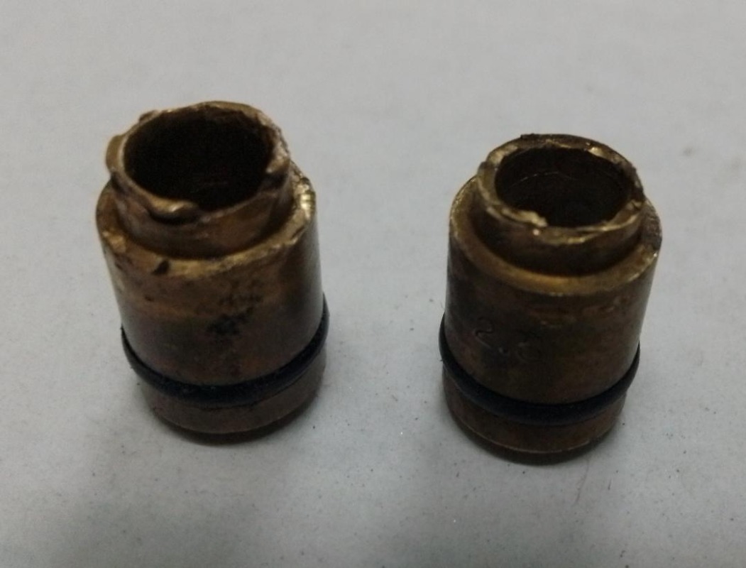

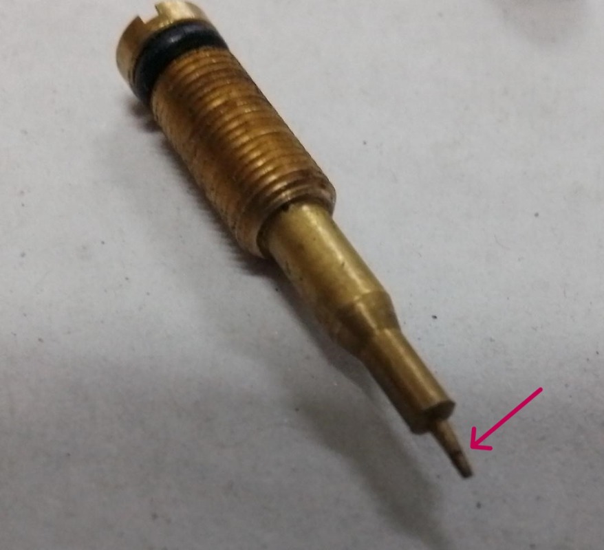

I replaced the parts in the carburetor repair kit, I changed everything except the needles, they were in good condition.

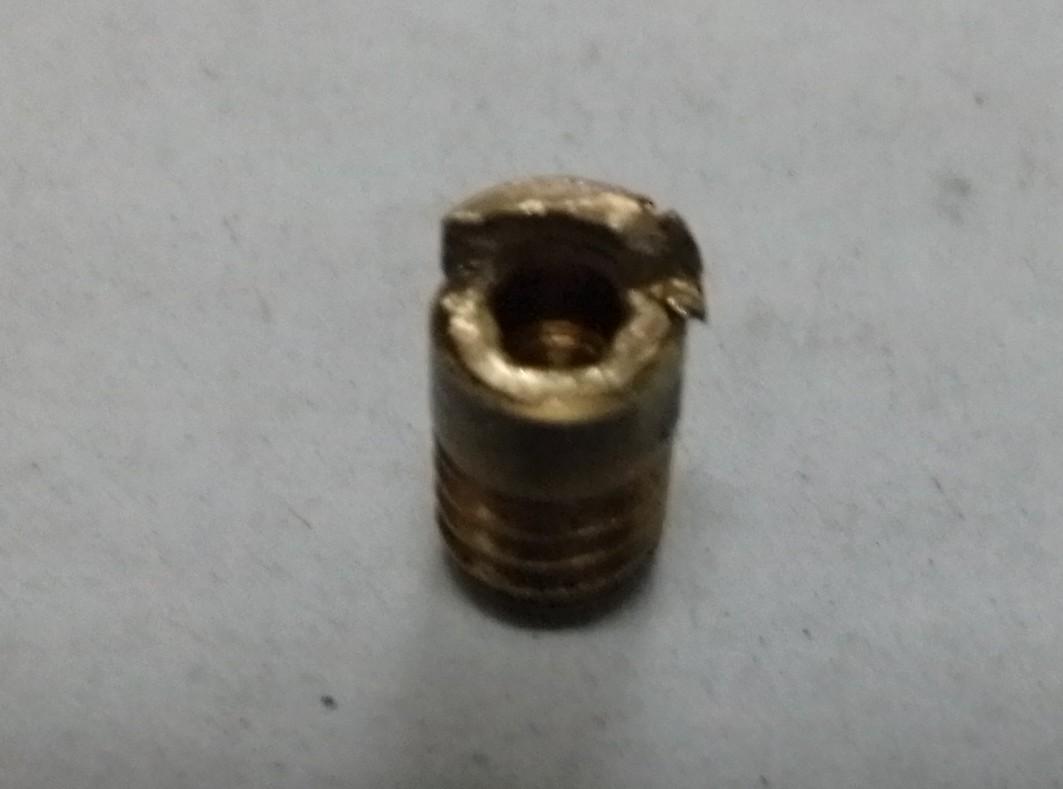

Some parts were very bad like this jet.
These two pieces had already been disassembled more than once, the strange thing is that they closed well and did not flood the carburetors.
One of the air regulation screws had a slightly bent tip, it has already been replaced.
Regarding the air regulation screws, I found them adjusted between two and a half and two and three-quarter turns from their tightening and I left them that way once they were changed.
It is a correct measure.

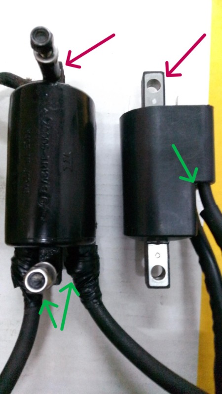

I already have the valve cover installed after having turned the engine until I see oil flowing through the camshaft bearings.
A new green light came on on the dashboard after cleaning the mud from the neutral sensor located under the crankcase.
This weekend I will try to install the new coils but not before asking the forum for advice, doubts continue to assail me...

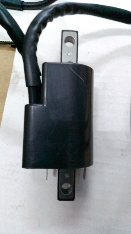

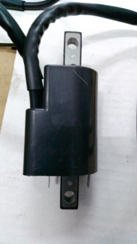

I bought a set of coils that replace the original ones as well as eliminating the resistance.

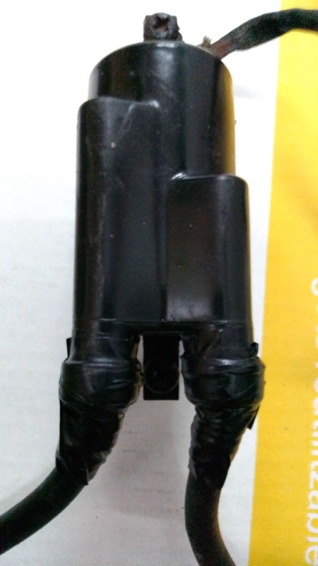

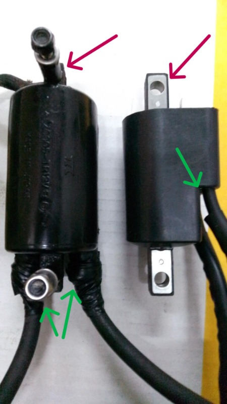

This is one of the originals.
This is one of the new coils.

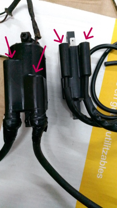

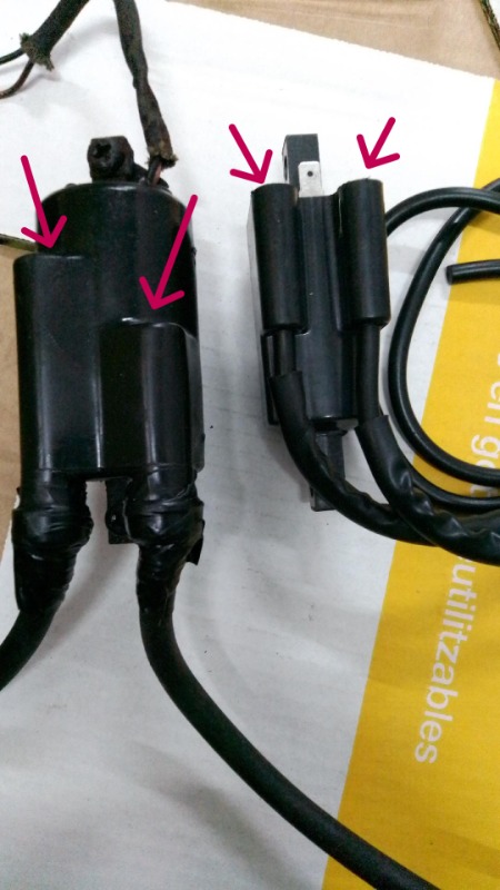

Now, the original coils are housed with the exit of the cables that go to the spark plugs parallel to the engine, that is, the two fastening screws perpendicular to the exit of the cables that go to the spark plugs.
While the position changes in the new coils, they are rotated 90 degrees with respect to the anchoring screws compared to the original ones.
The output cables to the spark plugs remain perpendicular to the engine block, one on top of the other.
The external appearance of the coils is also not helpful to me as they are totally different.
FIRST QUESTION:
I have the three original coils with the two wires marked 1-6,2-5,3-4.
How can I know which wire from each new coil feeds its corresponding spark plug?
How do I find out in the coil that feeds cylinder 1 and 6 which cable goes to its corresponding cylinder?
Or does the order not matter and they can be connected interchangeably?
SECOND QUESTION:

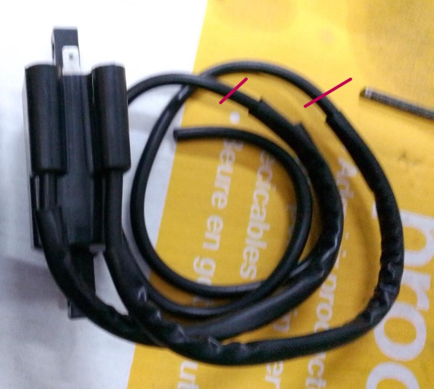

The length of the cables of the new coils is more than 30 centimeters longer than the length of the cables of the original coils.
Can the cables be shortened or is it better to leave them as they come from the manufacturer?
If they can be shortened, should the cables of the three coils be left the same length or can those of cylinders 3-4 be shorter to reduce space?
THIRD QUESTION:
Do the spark plug caps simply have to be screwed onto the wire or does some type of adhesive have to be applied between the wire boot and the plug cap housing?

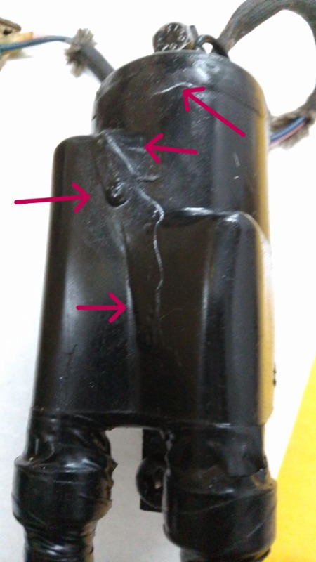

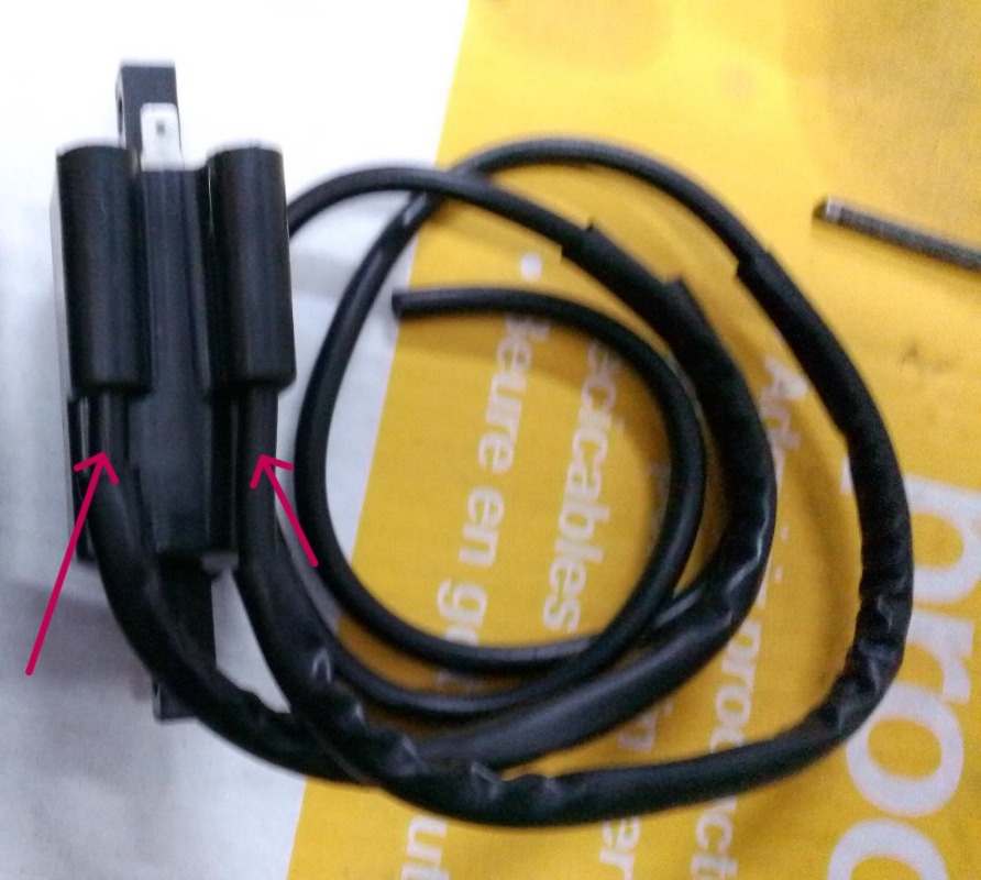

Finally, as something curious, this photo is of a coil "repaired" with a hot melt gun.

2 years 8 months agoFIRST QUESTION:
These are wasted spark coils. When they fire, each secondary wire will send out a spark simultaneously . It doesn't matter which secondary wire goes to Cylinder 1 or cylinder 6 ( for one coil) for cylinder 2 or 5 (for the next coil) or 3-or 4 (for the last coil)

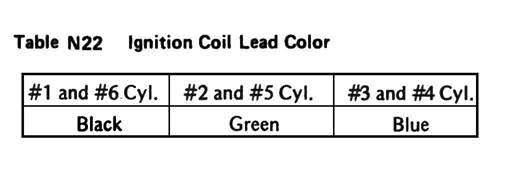

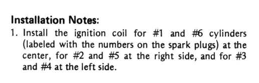

One coil will spark cylinders 1-6 (which is mounted in the center) Primary wires are yellow (+) and Black (-)
One coil will spark cylinders 2-5 (which is mounted on the right) Primary wires are yellow(+) and Green (-)
One coil will spark cylinders 3-4 (which is mounted on the left) Primary wires are yellow (+) and Blue (-)
SECOND QUESTION:
The secondary wires coming from the new coils should be solid wire which will have almost no resistance, so yes they can be shortened to fit better
You can cut them so that they fit nicely. Most people do this.
THIRD QUESTION:
You can just screw them on.

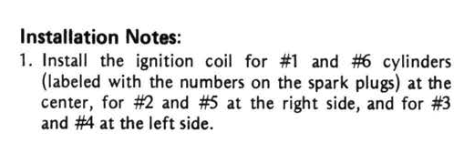

from page 47 of the manual
from page 49 of the manual
I follow the mechanics manual and know which color wire powers each coil.
My question refers to the two wires from each coil that connect to the spark plugs.
For example: in the coil fed with the black wire, which output wire must I connect to the spark plug of cylinder 1, both are the same.
The other question asked if I should keep the length of the wires that feed the spark plugs the same in all the coils or can I cut wherever I want.
- Posts: 3296
Re: THE MOMENT OF TRUE.
2 years 8 months ago - 2 years 8 months ago
As I mentioned in the previous post
It does not matter
I also answered that second question.
So, go ahead and cut them if you want
It does not matter
