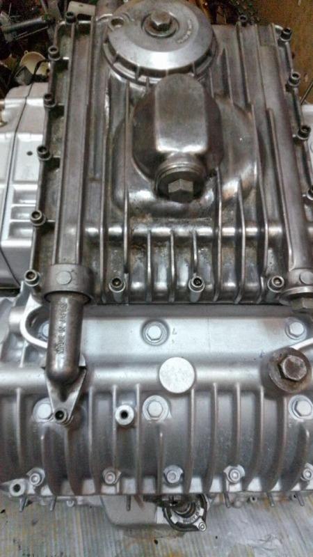

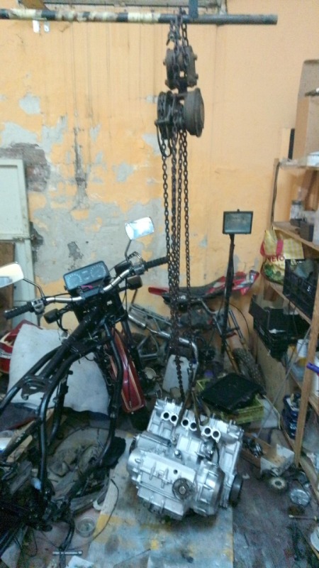

I have the engine almost ready, cranckase, clutch and gear covers.

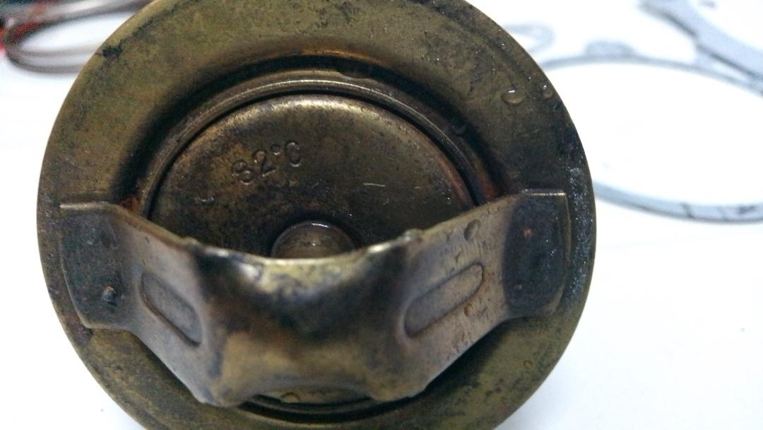

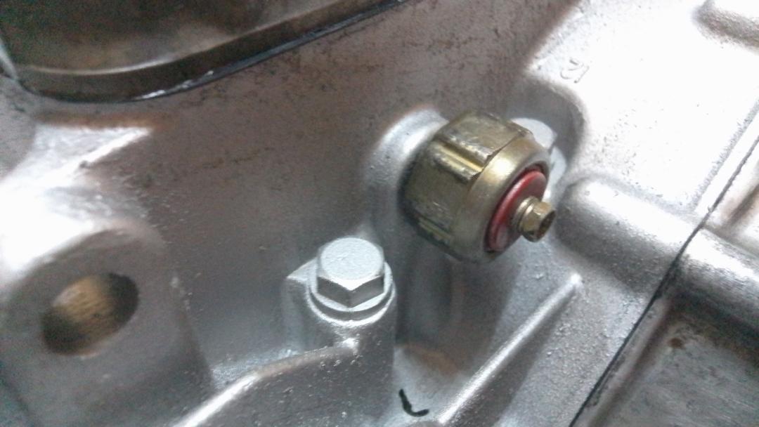

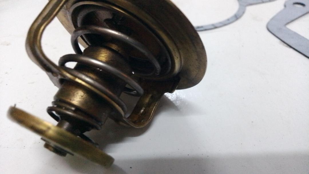

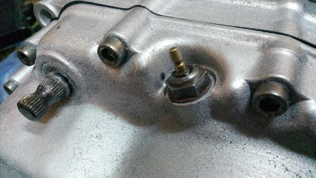

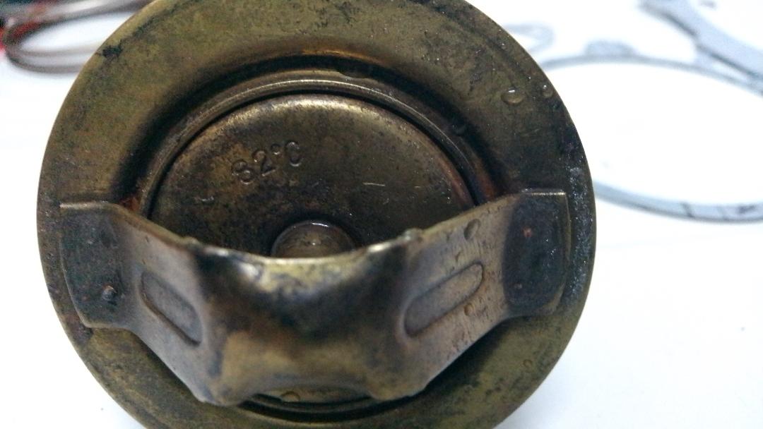

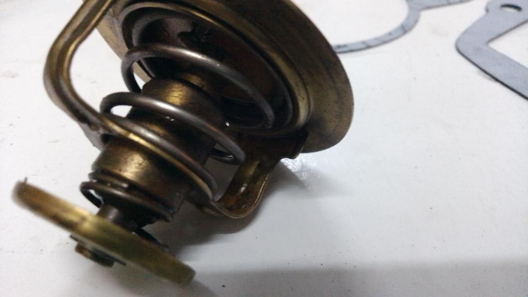

I have cleaned and checked the thermostat, oil pressure sensor and neutral sensor.
I have hung an old ternal from a main beam and now have the engine ready to lift and place on the chassis.

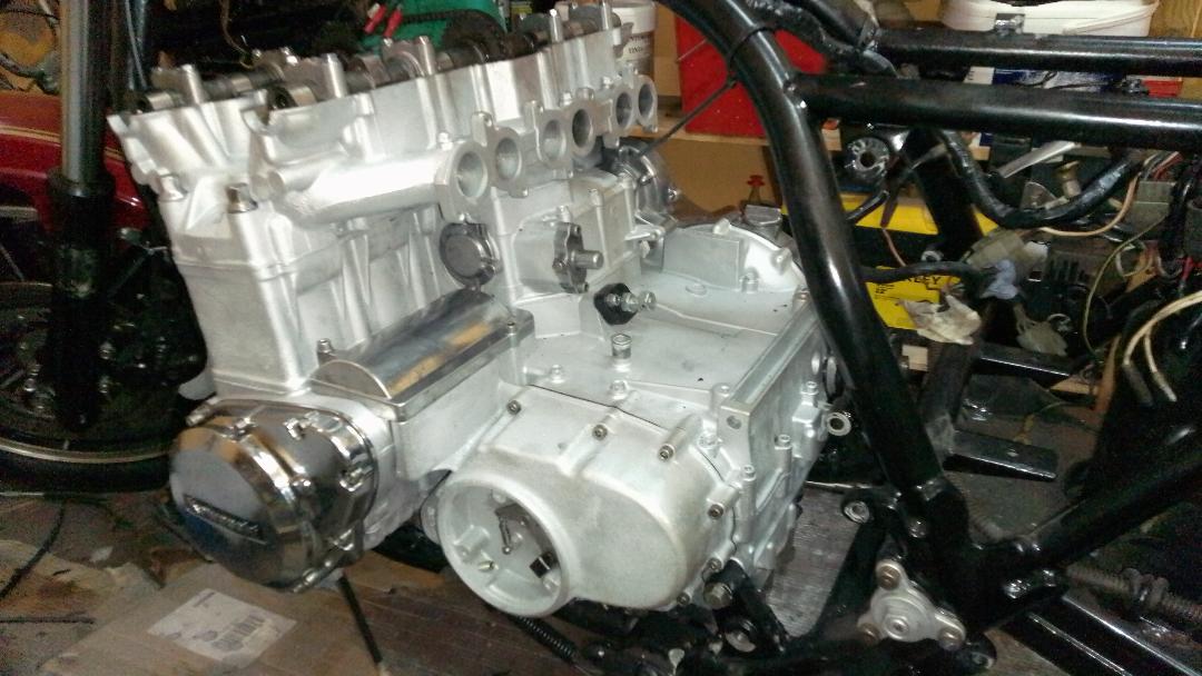

I already have the motor anchored to the frame.
Now a new challenge begins.

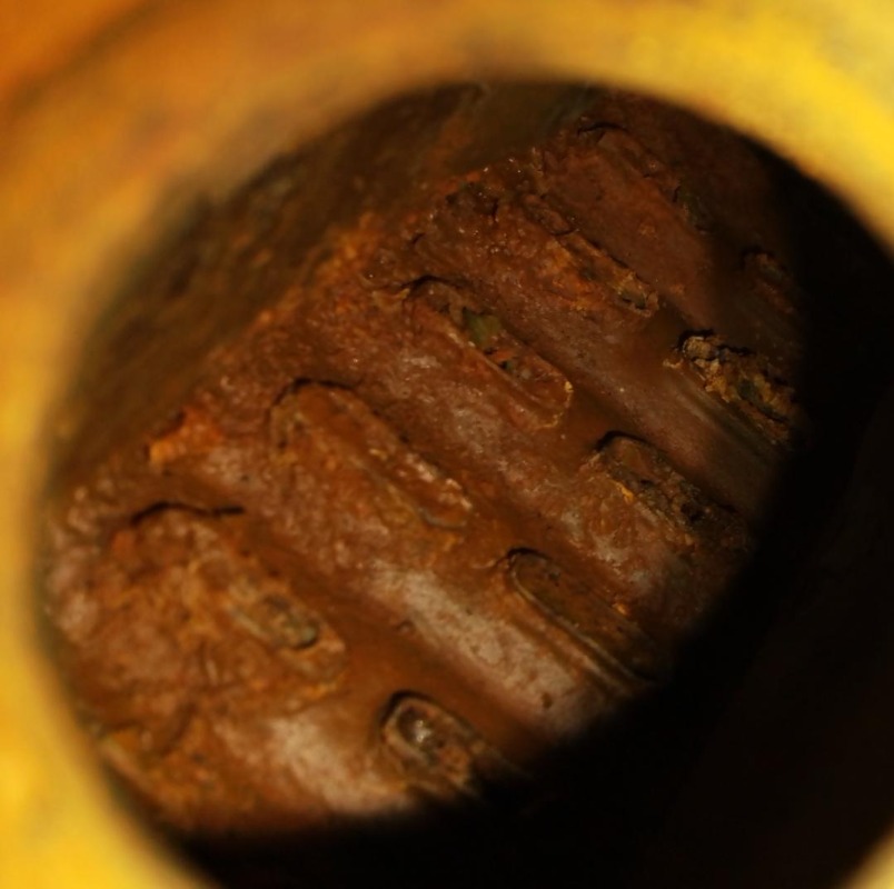

Make the radiator work.
Any suggestions for a miracle liquid to remove dirt or do I take it directly to a radiator repair shop?

That has to be the worst I've ever seen. Best to take it to a rad shop. I think even a rad shop will want to replace the rad core.
usually the rads are blocked with calcium or lime like deposits. Yours has iron rust blockage. Even if it was flushed out, so of the remaining rust deposits might break off and possibly ruin the water pump seal.
