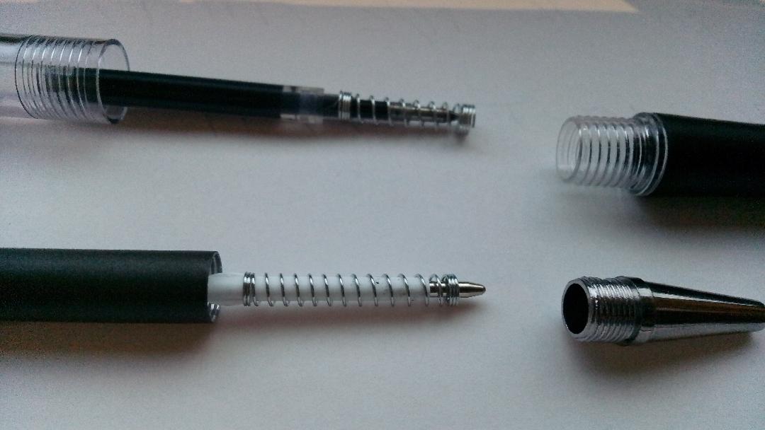

Thanks for the answers to the main switch issue, this week I will disassemble all the pens I have at home in order to find a spring that fits the part in question and be able to rebuild it.
- Posts: 3296
Re: THE MOMENT OF TRUE.
2 years 8 months ago - 2 years 8 months ago
Ball point pen springs will not have enough force. You need to measure the spring wire diameter, the length and the diameter and source compression springs more suitable.

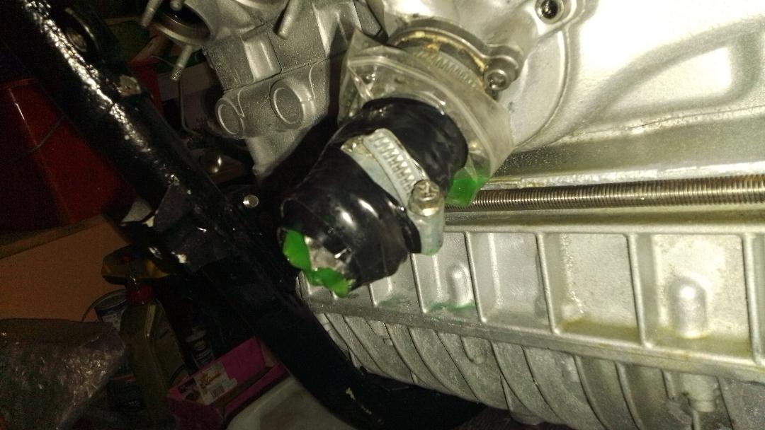

Yesterday, Sunday, I went down to the garage for a while to continue assembling the motorcycle.
I set about regulating the air/fuel mixture of the carburetors.
So I installed the air filter, plugged the water pump outlet and filled the engine block with coolant so that the seal would not run dry.
Yes, I know, It is not a pretty cap to look at but it is effective to use.
I added fuel and started the engine.
With a deafening noise he was doing 30/45 second stints with the engine running to adjust the carburetor screws until he saw the flames change from yellow to blue.

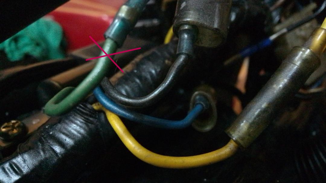

After repeating the operation several times, the coil that feeds cylinders 2/5, the one with the green cable, failed for no apparent reason.

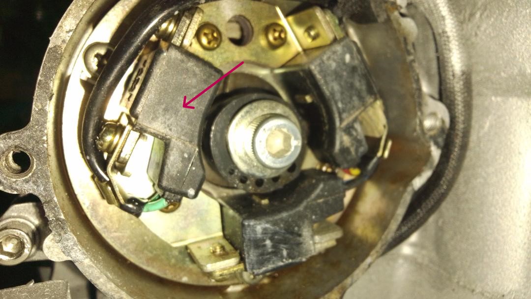

I separated all the connections until I reached the pickup and sprayed them with electrical cleaning fluid, nothing, no sign of spark. I loosened the electronic ignition advance adjustment screws and tightened them again, there was still no spark in that coil.
To check that it was not a defective coil, all three are new, I removed the spark plug from cylinder 2, disconnected the coil from the green wire that powers it and connected it to the black wire from the coil of cylinders 1/6.
I turned the engine over and there was spark, the coil didn't fail.
I also connected the green cable to the coil of the 1/6 cylinders and there was no response when turning the engine.
After a few attempts I gave up trying further.

The pick-up coil inspection / test is explained on page 242 of the Service Manual. It is a simple resistance test with a multimeter.
I fear your problem is a bad Darlington Transistor in the igniter. That is more likely.
This was a very interesting work around for an igniter replacement. Agonmarine's HEI ignition module replacement for the KZ1300 igniter . He basically used 3 GM HEI ignition modules to fire the 3 kz1300 ignition coils Probably cost him less than half what a new igniter would cost.
You could get lucky and find a igniter on EBay and if it came off of a low mileage bike, would be fine too.
What probably happened here was a bad ignition coil shorted and caused a high current draw on the Darlington transistor and fried the Darlington.
