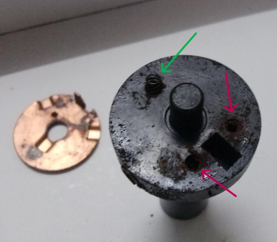

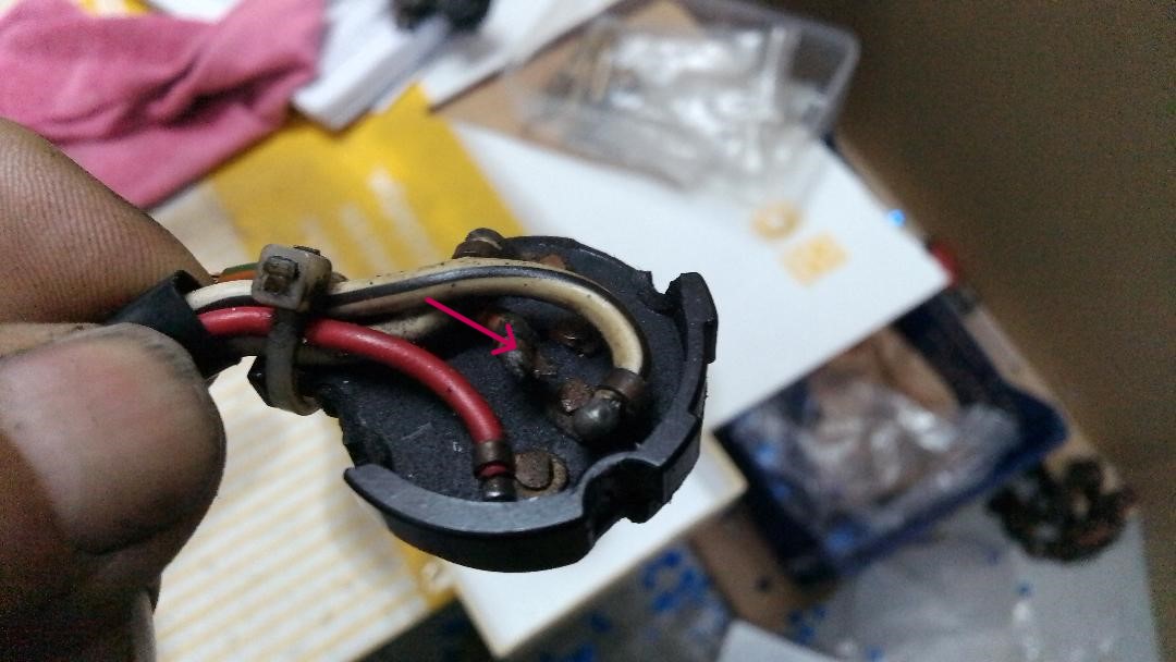

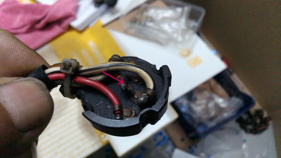

First of all, thanks for the advice and help from Kawboy and Biltonjim.
This Saturday afternoon I removed the lock.
There was only one spring of the three that push the copper plate.
The two small balls that fix the position were inside.
The orange and green wire lost its solder.
This lock has already been disassembled before and there are pieces missing, I think I will clean, lubricate the inside and reassemble it as it was.
If the seat closure works again I will be satisfied.

You really need to replace all 3 springs and 3 balls, clean up the contacts and the plate, then reassemble. It will never work properly unless the contacts are held in place, tight together. All of the charging and battery current flows through that switch. It might work and then one bounce on the road, and the switch will open and you will be looking for a tow truck to get home.
The other issue is that the tabs that hold the switch together will only take opening and closing a few times before they break off, then you will be looking for another switch. Do it once and do it right.

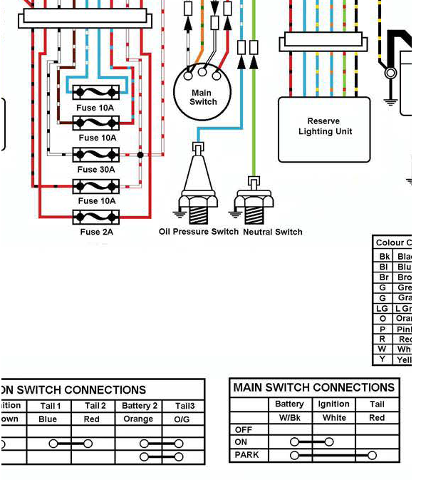

2 years 8 months ago - 2 years 8 months agoYou are dealing with a switch that has been worked on by someone who didn't know what he was doing and then bypassed a bunch of wires so you need to understand what happened and how to fix.
From the wiring diagram-
The white wire with a red stripe feeds power from the battery / regulator rectifier to the fuse box and feeds the 30 amp fuse and the 10 amp fuse.
The 30 amp fuse feeds the white wire with black stripe power to the Main Switch.
The orange wire with green stripe is soldered to the same contact as the white wire with a black stripe and that orange wire with a green stripe feeds power to the hazard signal.
As indicated in the wiring diagram (pic) when the switch is in the "on" position the white wire with a black stripe is connected to the white wire which feeds power to the ignition switch.
When the Main Switch is selected to "Park" the white wire with black stripe is only connected to the red wire to supply power to the tail light for parking the bike at night.
If the orange wire with a green stripe became unsoldered, it probably happened because the switch got too hot when in the "On" position, not because of an issue with the hazard circuit.
