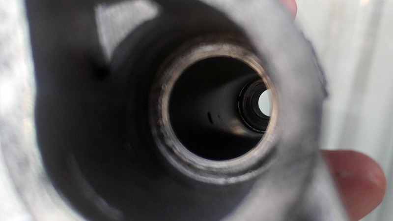

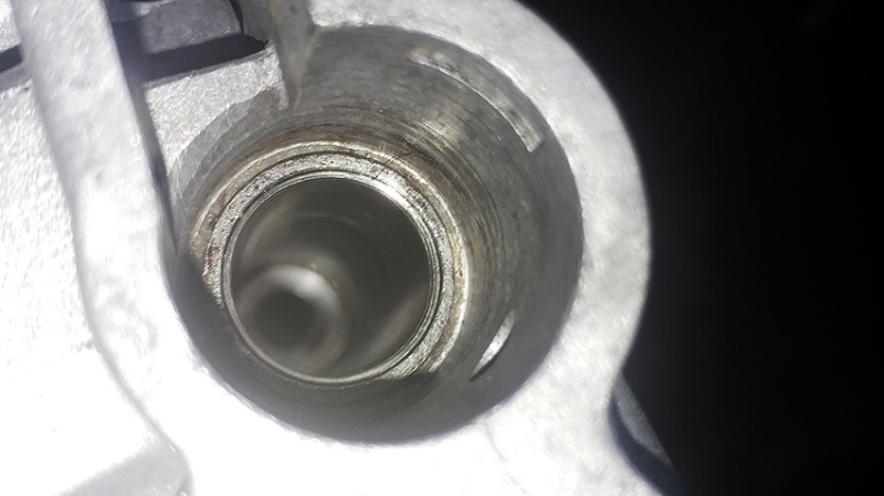

OK. More seriously. Just made a trip to Point Roberts and picked up a couple things. The tool box looks like new, and so does the front brake master cylinder!
Beautifully done! The new stainless steel sleeve is perfect!

Stan: Not including the shipping, how expensive was the resleeving?
8 years 8 months ago - 8 years 8 months ago
95 USD, but I paid a bit less because of a previous arrangement which didn't include unexpected time making a customized holder for these bikes. I was told that the next time would be cheaper because of now he has it set up. Either way, 95 is way better than anything offered in Canada.

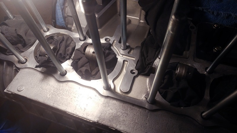

Time to clean up the crank case inside before flipping it over. There was some black residue from the old oil after sitting for years untouched, and a few pieces of the gasket which made it there despite stuffing rags in the openings around the rods.

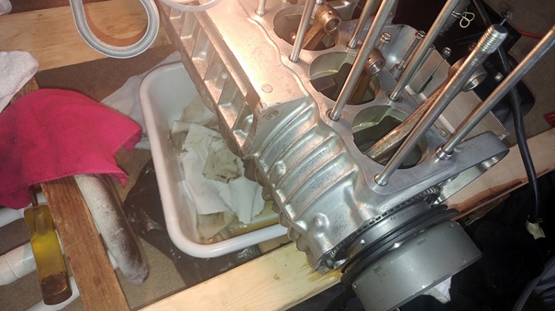

I raised the case off the ground, tipped towards the back, and put a plastic tub underneath. Then sprayed generously everything with WD40 and let it drip into the tub.

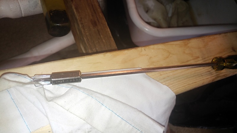

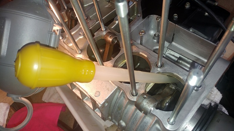

Next I bought this plastic injection tool for cooking and generously applied engine oil a few times everywhere, giving the crank shaft assembly to lubricate well at the same time.
Next I used a specialty long screw driver with attachment to pinch screws, but cleaning pieces of old bed sheet in this case.

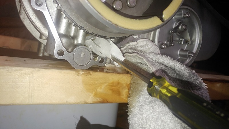

Then came the cleaning the bottom of the case from all the possible angles, applying oil, new rags, cleaning and so on.

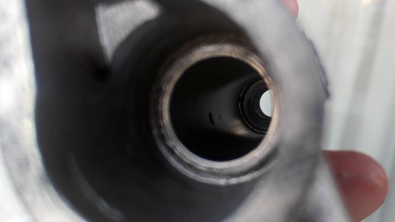

You can also do some extra cleaning from this bottom opening on the right side. The cylinders 1,2,3 are connected, so it's a good extra access point.
