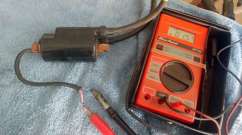

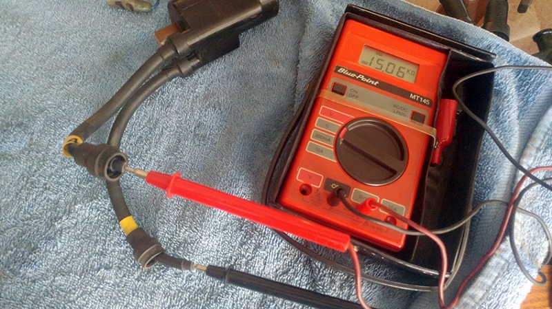

I am a bit ahead of myself but just couldn't resist (no pun intended) and tested the coils.
I am quite happy to announce the results. By the manual, the primary winding should read between 1.2 - 1.9 Ω, and the secondary 12 - 18 kΩ. Mine are 1.5 and 15 respectively for all coils. I am keeping them.

Stan: Just to be sure... You should check the error spec of your meter - for some ohm meters the error spec can be larger than the resistance measured.

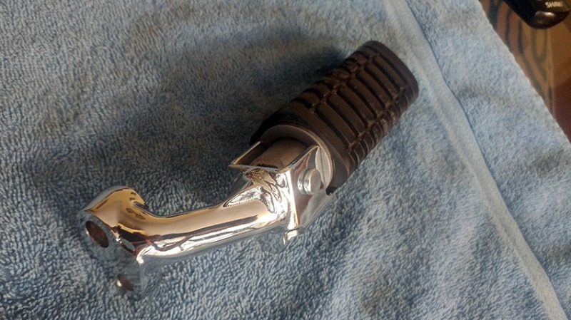

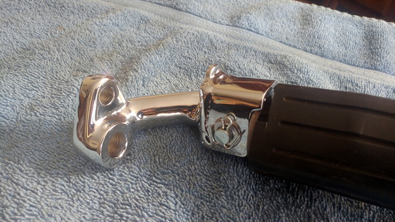

I love the foot peg parts - they look as though you have chromed them Really nice!

I haven't found anything about calibration in the instructions for this tester.. But based on my experience using it I'm quite sure it's accurate. And it's a Snap-On! I trust this brand. I'll look into checking how it reads a defined resistor if I get my hands on one, be it even just for academic reason.

Biltonjim: yes, all the parts are chrome plated, including that link assembly for activating the master cylinder and the switch. The brake pedal was fine and just needed a bit of shining.
Here is the left foot peg.
