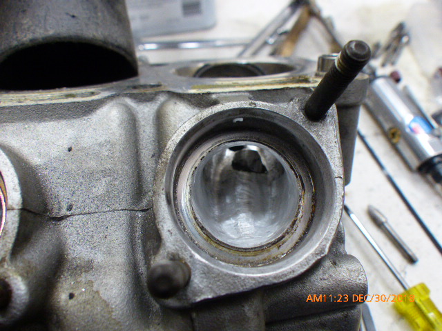

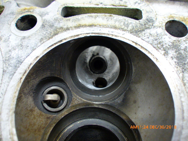

I will need to have the head machined slightly to fit 32 mm seats in the exhaust counter bores and 37 mm seats in the intake counter bores then install the seats and then machine the new seats to the factory measurement to give me 2.80 - 3.00 mm shims to start. We're going to get it right this time.
In the meantime when time permits, I got out the porting tools and started reworking the ports.
From this.
To this in about 20 minutes of work
From this.
