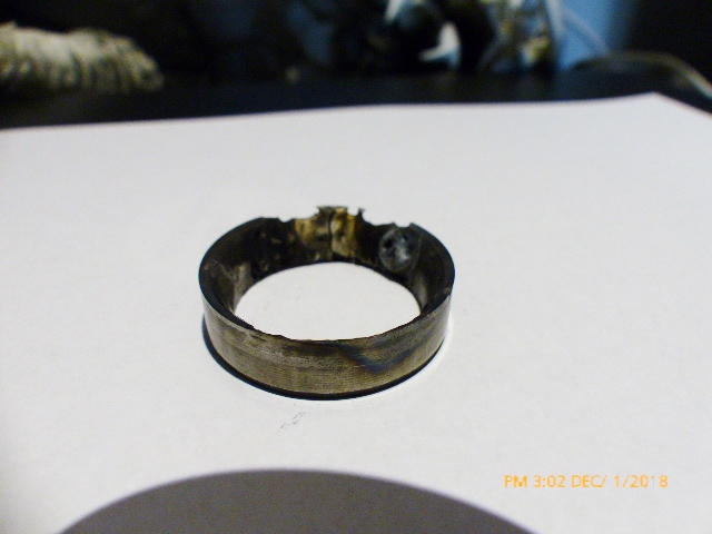

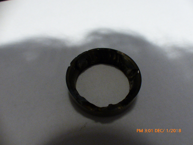

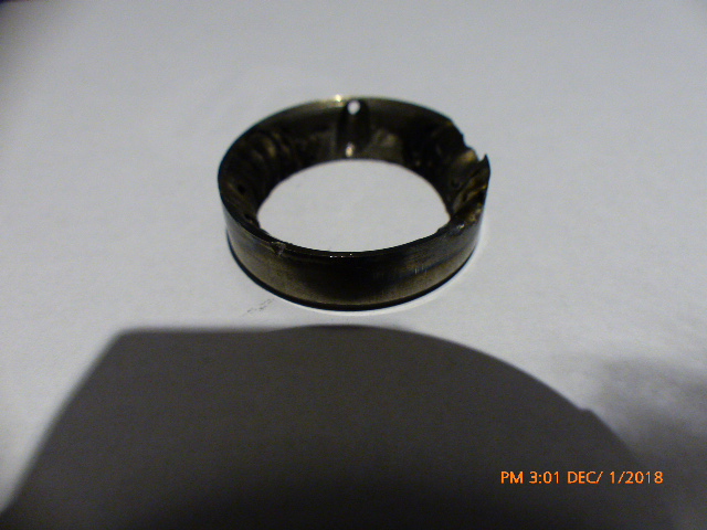

In a previous life I did valve seat replacement using a tig torch to lay a bead on the inside of the seat which sucks the diameter inwards and the seat will drop out. So for shits and giggles I got the tig torch out and had a go at one of the seats. First time around a little scary. Popping and sputtering, porosity, just ugly. After a second pass things settled down and the seat material formed a bead so I guess the seat was contaminated with oil and carbon which must have burned off.
Here's a couple of pics of what a seat looks like after laying a bead and popping it out of the recess in the head. And for the record, the recess is as clean as a fresh cut recess.i could just warm up the head and drop in a new seat.

The intake seat insert I pulled out yesterday - the counter bore in the head measures 1.440" x .375" deep and the insert bore is 1.140" dia. The .375" thickness is a bit of a problem since most of the 1.437 inserts on the market range from 1/4" thick to .340" thick. I did find one insert at 1.4445" x .375" by Serdi but have no idea what material they are made from. SB international will make custom inserts in any of their materials. I'd like to go the route of high nickel. I'll be pulling out and exhaust insert today and get some measurements for it then go shopping.
