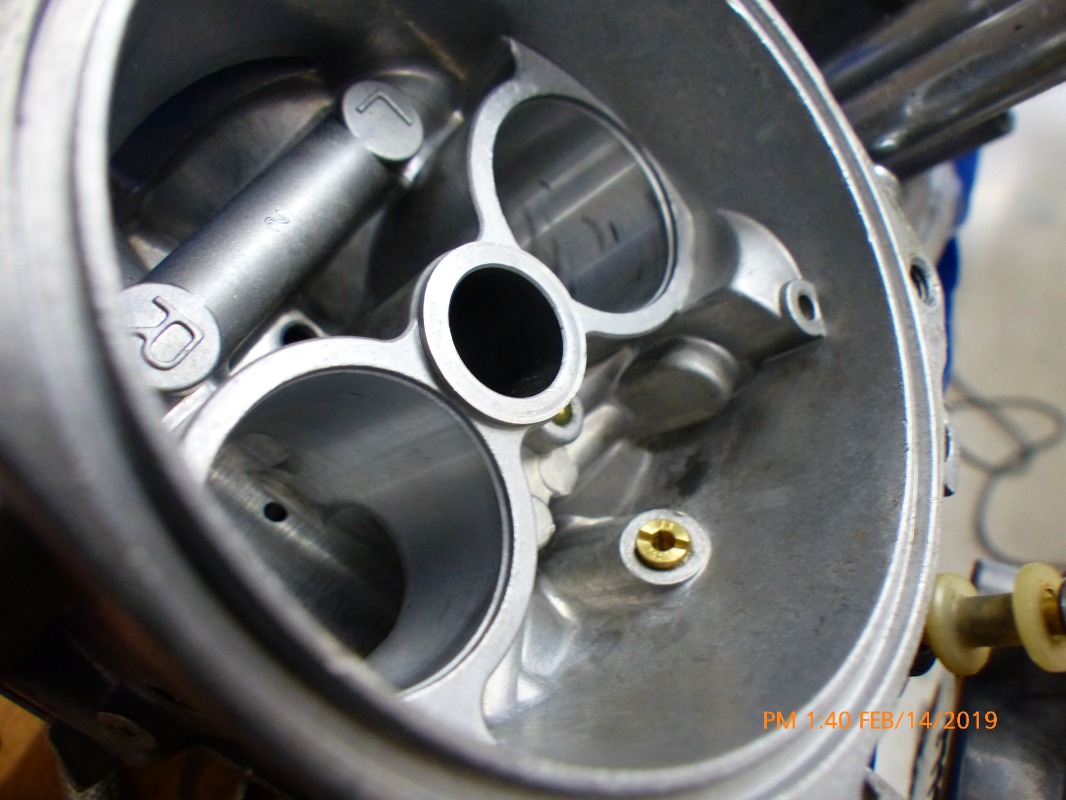

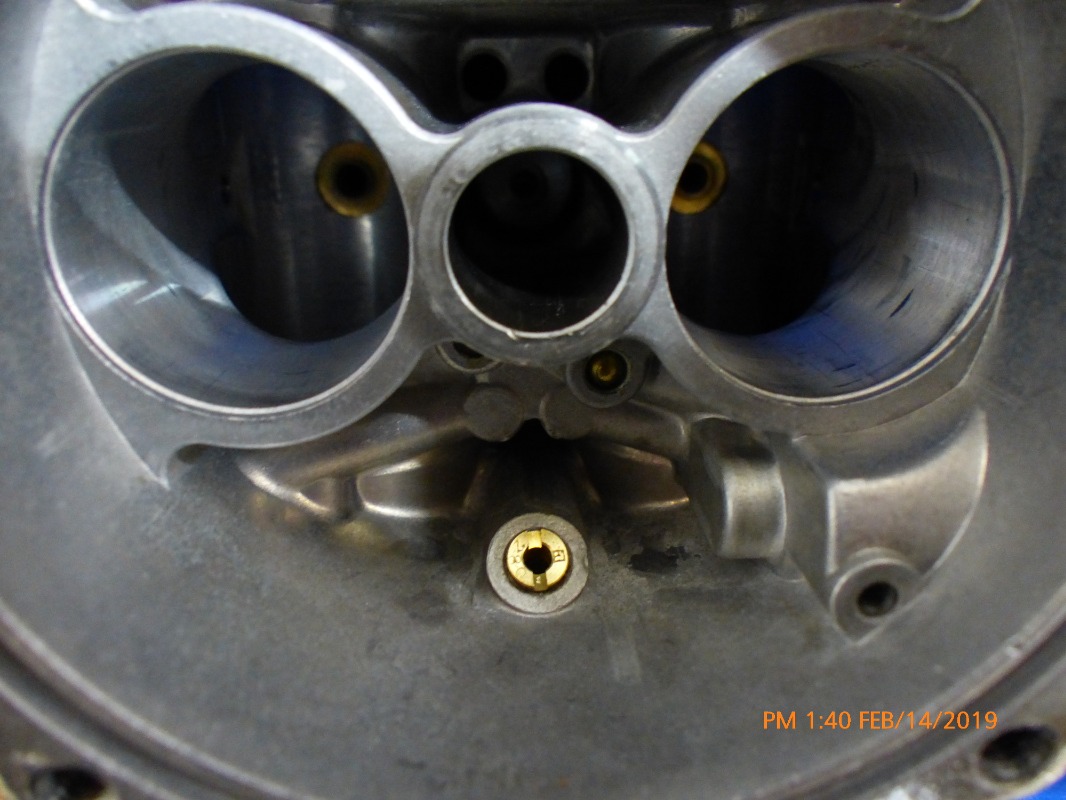

Popped the lid of of the carbs and started the mod. The thread size on the B42/55 is a 6mm x 1mm standard thread. The tap drill for that thread is a #9 which is .194" I measured the bore of the air jet in the body of the carb at .191" so there was no reason to have to run the #9 bit in the hole, just tap it out to 6mm X 1mm. Tapped it in 5 threads, cleaned the hole with a vacuum and pulled the choke plunger out to ensure no aluminum thread filings. Inserted the jet and Bob's your Uncle. So I've choked down the air to the choke circuit from .191" to .110" using the B42/55 X #280 jet.
I also like the nice clean look. If I decide down the road to change the orifice size, the B42/55's are available in #70 (which is .7 mm) to #290 (which is 2.9 mm)

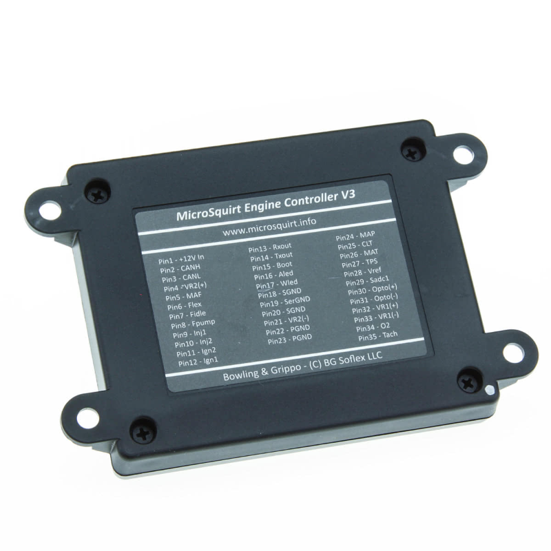

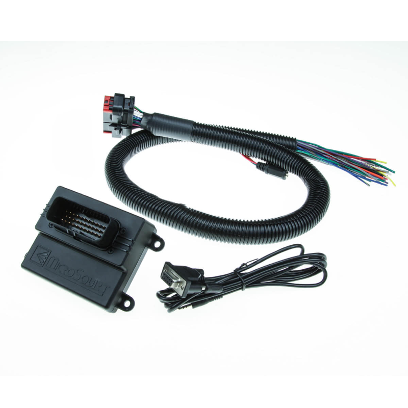

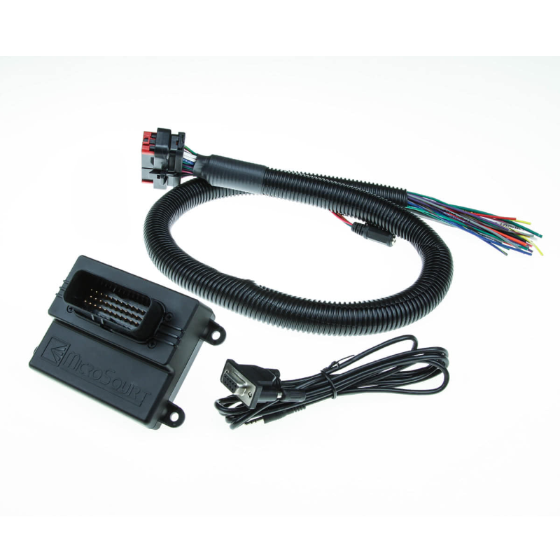

It's Cyber Monday here in North America and online shopping deals abound. I've gone and done it now. Went to www.diyautotune.com and they're having a cyber Monday sale at 10% off, so I bit the bullet and bought a Microsquirt with a 30" harness for the project.
Microsquirt V3- a stand alone programmable ECU that will run 2 circuits of injectors in batch fire, and up to 4 channels of ignition, so by using 3 channels I can run the KZ in wasted spark. It has the ability to run in either speed density ( throttle position + manifold absolute pressure) or Mass Airflow. It also has provisions for O2 input in either Wideband or narrow band.
What I really wanted was to buy a Megasquit 2 kit and build it but size wise, it would have been a bugger to fit. The microsquirt has all that the Megasquirt 2 has but size is small due to surface mount Technology (SMT) electronics and that keeps the board small. The entire Microsquirt measures 4.71" X 3.13" X 1.67".
