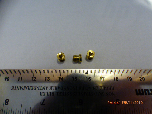

The parts are coming in and starting to pile up. Maybe when I get back from Panama, mother nature will warm up the earth enough so I can heat the shop without calling Alberta to turn up the gas flow.
These little beauties came in today.
B42/55 air jets in size 280 (which is 2.8mm or .110")
