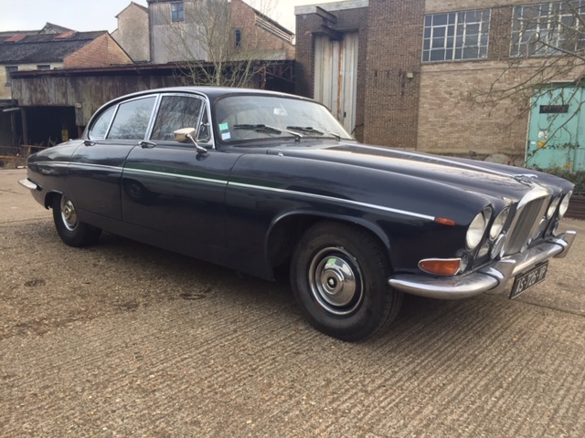

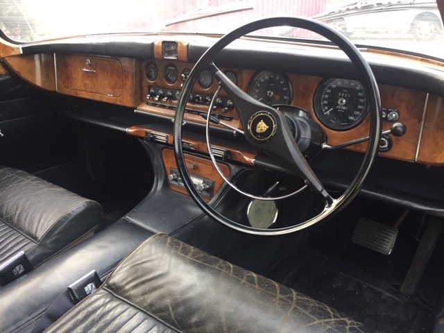

I picked this up in France last weekend. Great condition, very little rust and RHD but wouldn't start, so the guy selling it had no chance to flog this in France. I picked it up for a song. Will get it running and plated/insured and then will flog it off for hopefully a bit of a profit. Proceeds to go towards the valve stems being ground and the head shimmed by Oz from Zed Parts.

A Shaguar!
