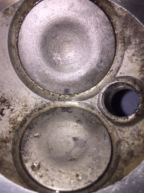

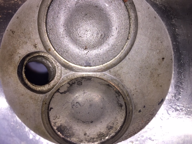

Ok, checked the timing and it was spot-on, so I know how to do it, just didn't do it right the first time.
So... last night I pulled the head once more.
Hereunder what happens if you get the cam timing wrong: the valves prevent each other from closing and then scrape each other and snap shut, resulting in the damage you see, which I imagine is the same or worse on the other side of the valves where they are supposed to seal.
So no surprise I have no compression!
I'll take the head to the guys again and see what they say. They may be able to salvage the valves, but I may have to buy 12 new ones.. $$$ OUCH!

Sorry to hear of this but it's what I expected. Zero on compression is usually bent valves or holes in the pistons. Let's hope the seats didn't take a hit too.
Some lessons learned are expensive. I had valve seats done on a head and then found out that the seats were already too deep. So $200 thrown out the window. Just received new seats from Kibblewhite and I'll have to machine them to fit the head then have the new seats cut. $234 CDN for the seats, I'll machine the seats myself and install, then back to the head shop to get cut (another $200)
