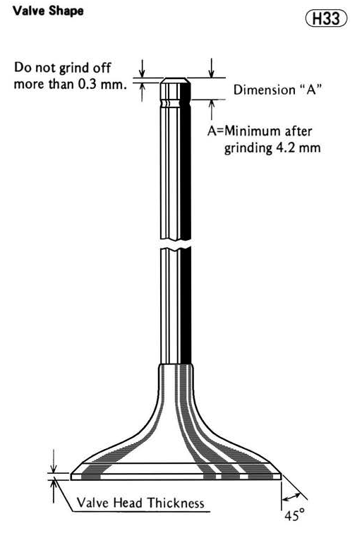

7 years 6 months agoBucko wrote: I'm surprised you could take 0.3 mm off the valve stem and still have the keeper grove in the right spot to ensure the valve bucket is pressing on the valve tip and not the spring. Good to know.
And it's in the Service Manual
Its right on the limit and indeed I was lucky.

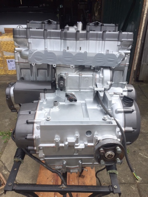

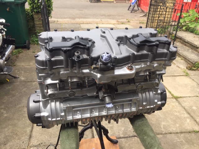

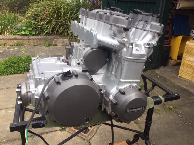

Spark plugs ordered and inlets/exhaust plugged for storage. Now the engine can be dropped back into the frame and the work on the frame can begin. Starting with front forks and making changes to the rear of the frame to accommodate the seat.
I have found some 2017 Triumph 1200 Explorer front forks that are the same length as the original Kawasaki ones. I'll have to investigate if these will be up to the heavy 1300. If not I'll stick with Ducati Multistrada Ohlins, I know those will be fine, but they are expensive!! I also found some awesome Hagon rear shocks that can be made-to-measure for length, style and my weight. Not expensive!
Thanks all for the help and encouragement on the engine work. It looks great and is back in good health, considering how I found it.

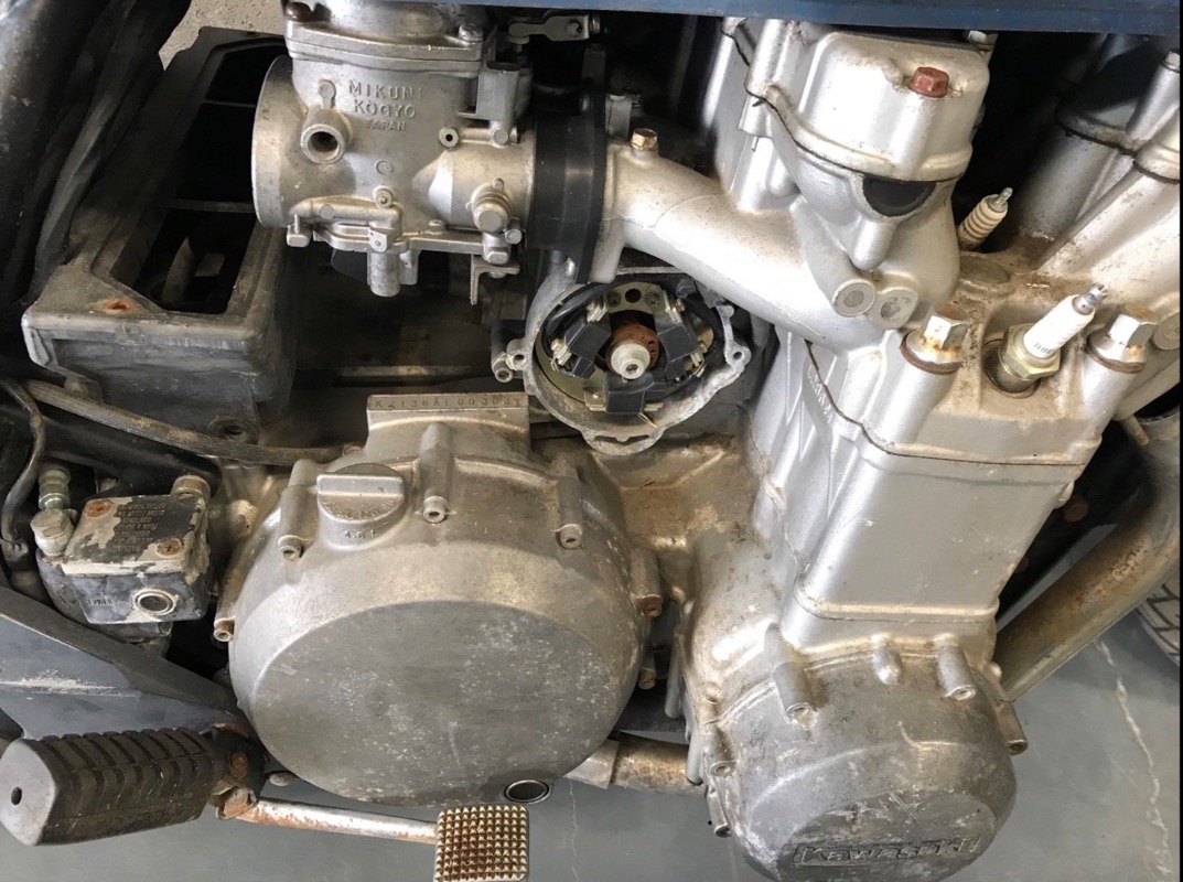

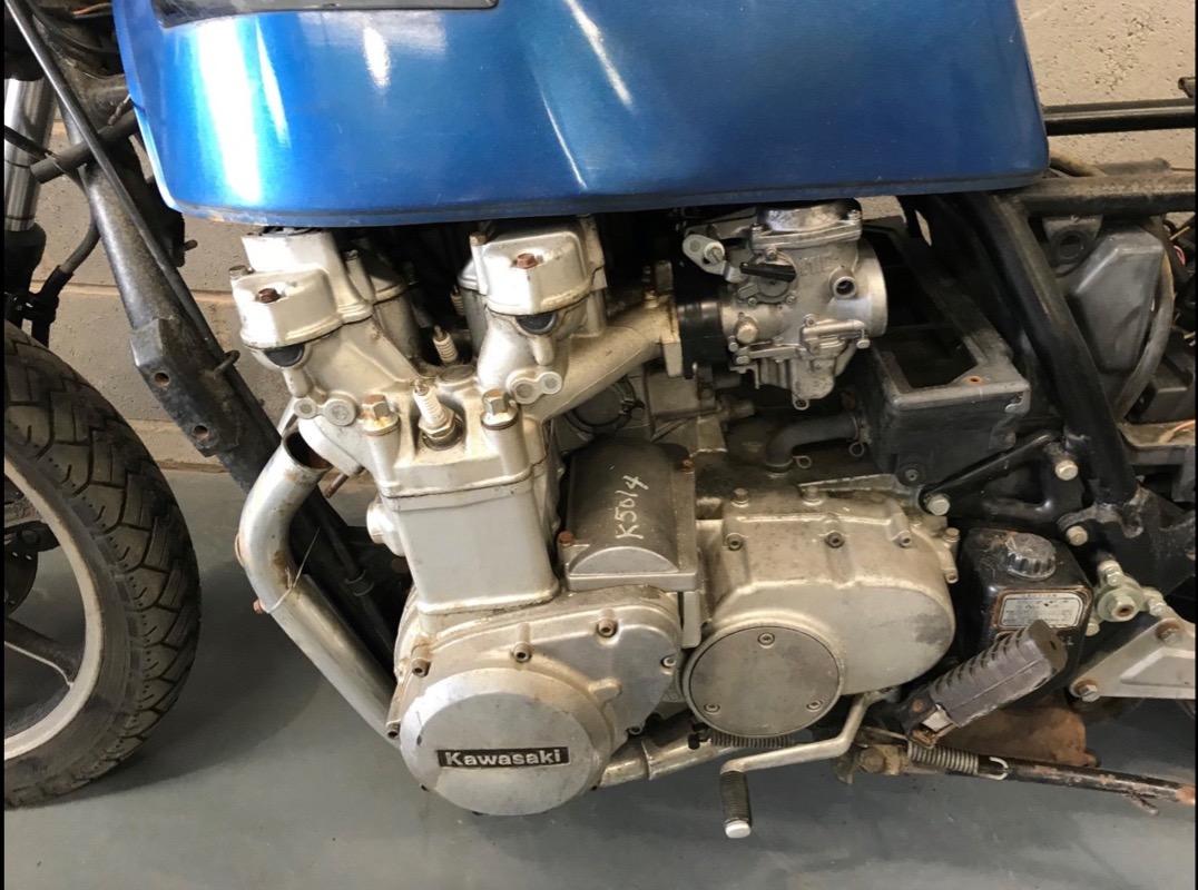

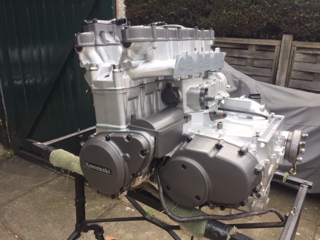

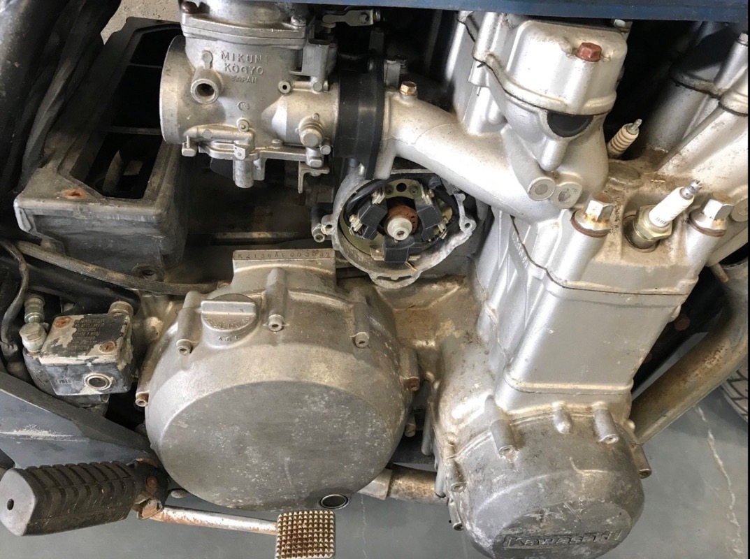

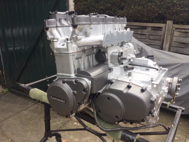

As was:
And now:
As was:
And now:
