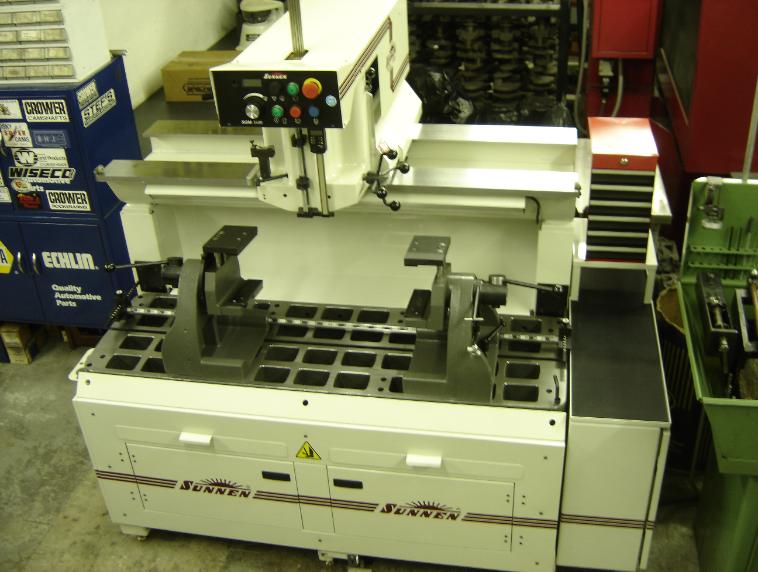

I bought 37 mm and 32 mm powder metal seats from Kibblewhite. The OD's are oversize by about .012" when accounting for a .005" interference fit. I have a tool post grinder on my lathe and I'll chuck up the seats as lightly as I can and grind the excess off. Then the seats can go in the head. The ID's are undersize and the height is too tall but that machining can be done by the seat cutter that I've lined up to do the work. The local machine shop has this machine and she's a beauty. When they cut the original seats for me, they all fell within .002" in depth. My only mistake was NOT taking that stem depth measurement before asking for the seats to be cut. Had I done my homework, I would have known to go straight to seat replacement.
This is a Sunnen SGM1500 with an air float deck for aligning. A really well thought out machine.
