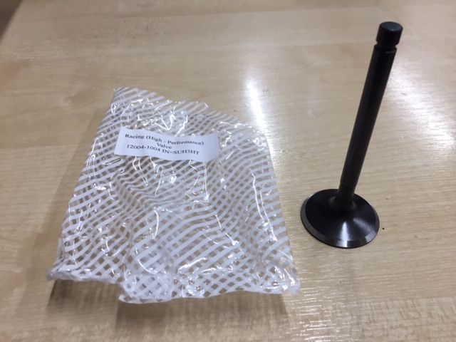

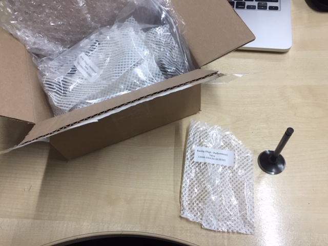

Getor valves turned up today. They are looking good!
This afternoon I'll drop them off at the machine shop and then it is waiting for the head to come back.

Great arrival and just like I said earlier - they work great on my bike! You will be happy with them.

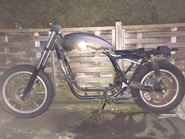

Purists look away please!
My Kawasaki 1100 Zephyr tank arrived, so I tried it on the frame. Fits almost perfectly! The tank front lobes go perfectly over the rubber bungs on the frame, I just need to lower the rear edge a little and then I think it will be perfect.
Mock up attached.

Nice rain drop silhouette. With that seat I don't think you need cutting down the frame. Unless going for a 'chopper' look.

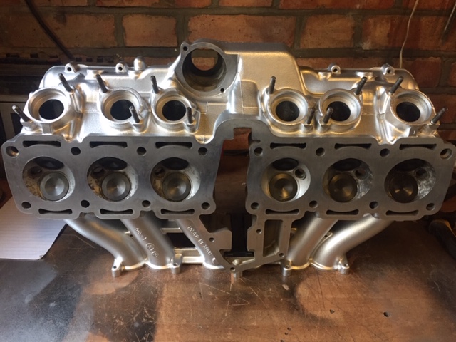

Ok, got the head back with new valves:
In the process of inserting the valves they scratched the paint so I had to give it a quick touch-up, but I can't bake it (as it has new valve rubbers) so have to be careful from now until the engine runs and it can bake whilst running.
Got the head back on and properly timed this time :S It all runs smoothly when I turn the engine by hand. Back to where I was two months ago!
Now the next issue is shimming. Obviously with new valves that all went out and here are the new measurements:
