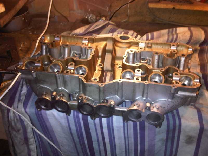

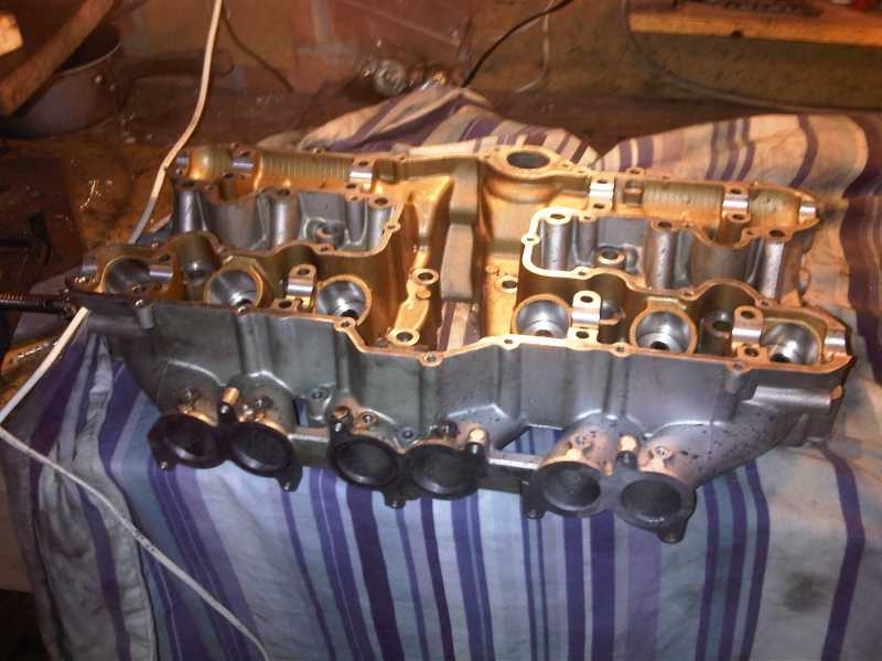

I have stripped my whole top end down to the crankcases to carry out a full overhaul over this winter.

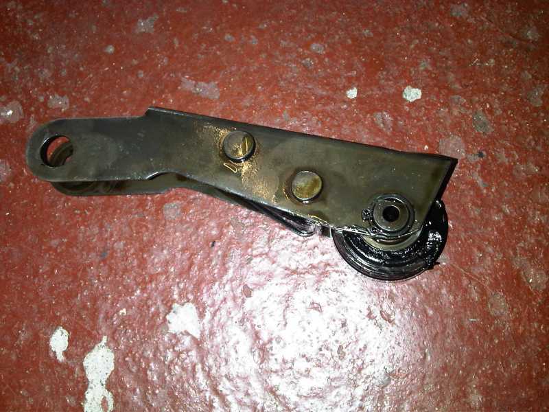

The top end had a slight "tick" when running which turned out to be the top of a valve guide had snapped on number 5 cylinder.
Also the lower rubber guide wheel on the camchain tensioner had failed & the bearing was seized so its been worth doing the job just to find those 2 problems already.
I also intend to hone the cylinder bores & fit new standard rings & re-grind the valves & replace valve guide oil seals & Water pump seal & mechanical seals.
Basically its a full overhaul which I am now well into.
Cylinder Head & Block on the bench

The "offending" Tensioner wheel which seized & failed. Interested to know if anyone else has had this issue as its the first I have ever had or heard of ?????
The bike had covered 30,000 miles at strip point & the bores were well within service limits but the rings were 0.5mm less than service limit so I am hoping this was why it liked using oil at high revs. I would imagine it is & have heard the rings on early 1300's had issues on some batches of bikes.
Hopefully new rings & valve seals will help its drinking habits !

I bought one and after fiddling around got p#!*^d off with thing and stripped it down just like you have. Stuff the standard pistons, bought a big ore kit on ebay for about $250 and what a difference. I would recommend you go for this.
As for your rubber roller, well mine did not exist and the chain was running directly on the bearing, found the remains in the sump. Remember to change the nylon timing gear and fit the zzr tensioner.
Check the photo with new roller next to what was left of the origional one.

The FIRST job I do on any 1300 is the CCT (zzr1100 type) as have seen the results of not doing it.
New nylon gear all ready to go in along with rubber wheel (very bad design) but no alternative.
