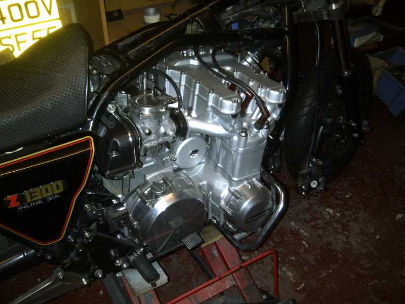

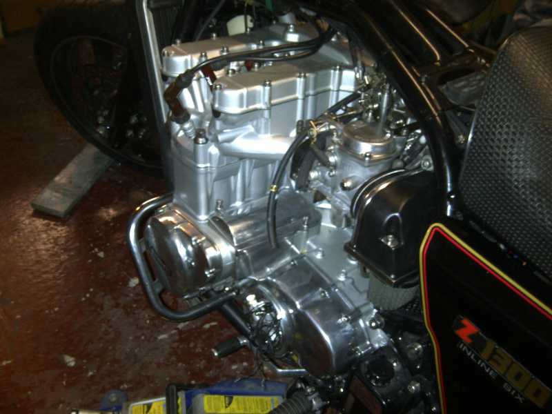

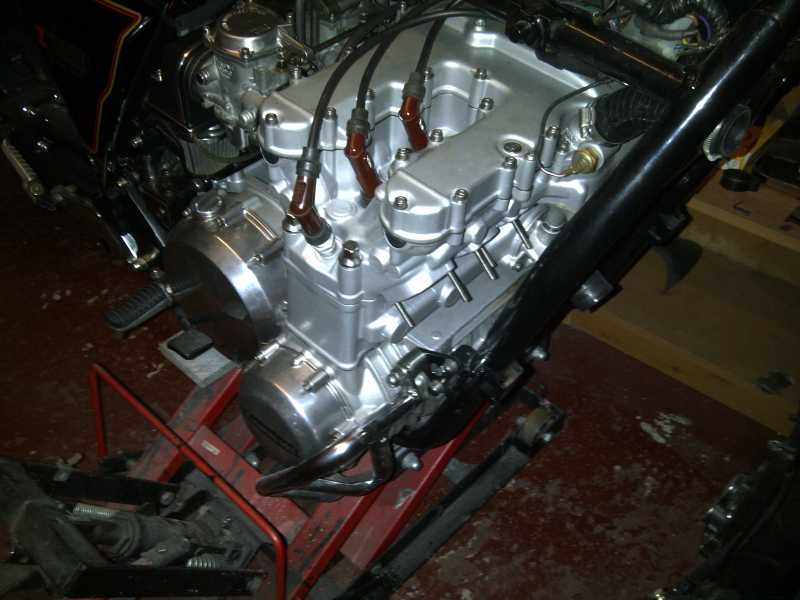

UPDATE 27th JAN 2014.
Had a good weekend working on the bike (raining constantly so not much else to do) & got everything back on the top end including the cam cover & coils.
Got the carbs & air filter box back on too, so pretty much done at the top end.
Next job is fitting sump, exhausts, fan & radiator, then fill with oil & coolant & hopefully "kick it in the guts" as they say & see if I have sorted the oil burning issue.

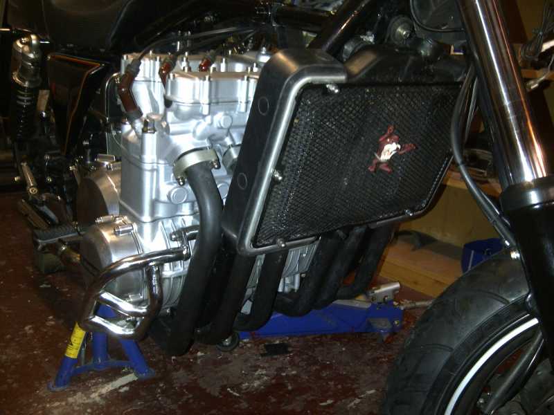

12 years 8 months ago
1st FEB 2014
Just about complete now.
Sump, rad, fan & exhausts all back on so pretty much ready to start once I fill with oil & hook up dummy fuel tank.
Got some of the parts including tank & new headlamp fairing being professionally painted which should be back soon.
I also refitted the Hydraulic Clutch Conversion as it needed a new mounting plate.
