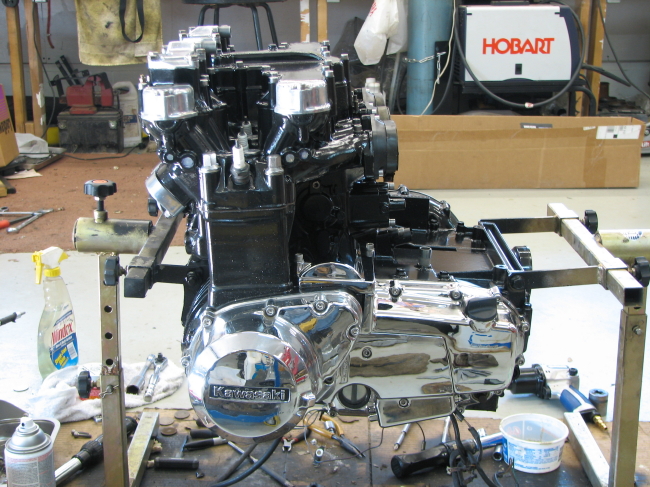

Hi Guy's. I've been reading through this topic, and would like to add a couple of things. #1: When doing a top end rebuild, do not use the Vesrah head gasket. I've never gotten one of these to seal. They always leak water. Cometic makes a head and base gasket for the 1300 sixes, that seems to work very well, if the original is not available. #2: After doing the CCT upgrade, the nylon idler gear on the cam chain, seems to get eaten by the cam chain in about 50,000 miles. I'm guessing it's the higher spring pressure of the newer tensioner. I'm currently talking to a local machine shop, about machining some from steel, (will probably cost about $150.00 each). #3: If any valves are needed, Kim at Carolina Cycle, can set you up with stainless valves for about $30.00 each. If you ship the entire head, he can also custom make valve guides and seats. It's also a good idea to replace the valve springs, while your in there. Performance springs for the KZ900 and KZ1000 are a direct swap, you just have to buy 2 sets, and have a half set left over. With the stainless valves, and stiffer springs, anything over .004 inch valve clearance, she'll rattle. I'd never heard of using rings for a CB750 in our sixes, but the 1977 and 1978 CB750's are the same bore as ours. Definitely worth looking into, considering our rings are about $60.00 a cylinder, and you can get the Honda's rings aftermarket for about $25.00 a cylinder. Here's a couple of pics, of the last 1300 I put together,(ZN, not KZ). I hope you like em.

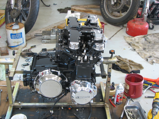

- Bob4717
- Posts: 14
12 years 11 months ago
Hello, I like your engine stand, I was going to try to make one. What kind is yours? It looks like it will fit other motors also. Thanks! Bob
- Mikez
- Posts: 241
- Thanks: 14
Very nicely done!
