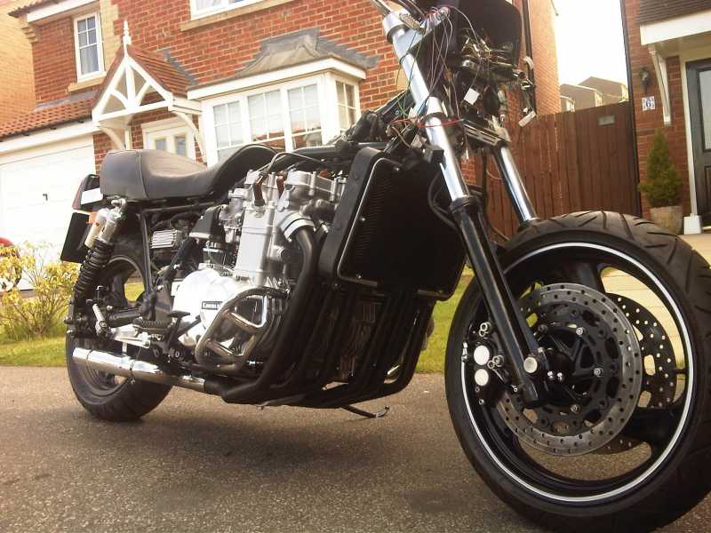

Mikez,
No problem sharing any info on my bike with all you guys.
Please see best pictures from different angles I have of the said airbox below.
Its basically the top section only of the standard airbox, with a flat stainless steel base with 3 x round sleeves welded on to accept the 3 K&N filters. Its basic but works a treat & DOES NOT REQUIRE RE-JETTING.
The standard airbox & filter on a Z1300 restricts the airflow anyway (which is why most run rich) so this mod allows the bike to breath & run much smoother in my findings.

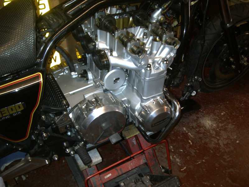

JANUARY 4th 2013.
Another good days work......cylinder head fully built & valves shimmed with ignition pick ups & inlet rubbers fitted.
