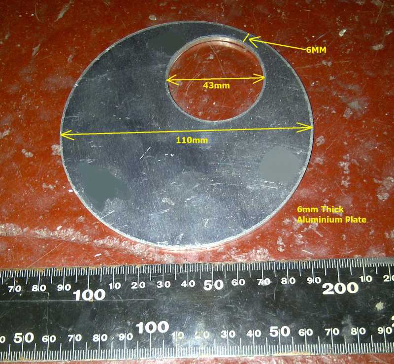

You need to make the plate yourself from 6mm alloy plate.
The hole for the slave cylinder needs to be 43mm diameter & 6 mm from the outer edge.
Once you have it made just offer up the original cover plate with the 3 holes in it and mark it for position of the 3 holes.
Do the same with the cylinder once in the 43mm hole.

The only part you need to make is shown below. Any metal fabricator with a laser cutter can make this very easily.
Once you have the above plate made, you need to use the original cover plate (with 3 holes) as a template for making the 3 holes in this new plate.
The part you need to be careful with first is the very TOP bolt hole also needs to line up with the top mounting hole on the slave cylinder. DO THIS VERY CAREFULLY BEFORE DRILLING HOLES.
This means positioning the plate carefully into place to ensure the CLUTCH ADJUSTMENT BOLT IS DEAD CENTRE of the 43mm hole, as when the cylinder is bolted in the hole, the centre of the piston must be as close to centre of the adjuster bolt to push it correctly. You may also need to use a spacer INSIDE the piston to take up the gap between it & the adjuster bolt.
This is the reason why you dont just get the 3 holes put in the plate upfront........it needs to be done with the bike present.
All the holes you drill in the plate need to be 7mm.
All the clues are in the guide above...........look at the photos carefully & it should make sense.

Can you use the stock cover to do this or isn`t there room in the back for clearance or because it might not be flat ? I cant get to my garage to take a look at it because of all the snow.
a bunch of old kawasaki`s
Re: Hydraulic Clutch Converstion
12 years 9 months ago
Pete,
The main reason you dont or cannot use the original cover is that it is "domed" & you need a flat surface to mount the slave cylinder onto with its 3 bolts.
