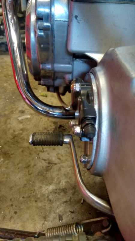

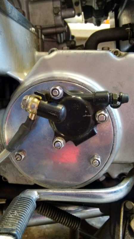

Just completed the hydraulic clutch conversion on my bike and it’s a massive improvement on the heavy cable operated lever. The installation however was not without its problems and didn’t go quite as smoothly as the instructions on the forum. I used the master and slave cylinders from a Kawasaki zzr 1200 and for the mounting plate I used 5mm aluminium. I couldn’t get 6mm as it said in the original posting.
On the first attempt the mounting plate didn’t seem strong enough and you could see it flexing when the lever was operated, and the clutch operation was a bit hit and miss.
I’m not an engineer but I reckoned the aluminium I was using was too soft. So this is how I managed to get it to work, I must add that if you are from a precision engineering background and of a sensitive disposition stop reading this post now. I’m a builder, so some of my engineering solutions may be a bit suspect.
I used a second aluminium plate and glued them together with epoxy resin; this gave me a 10 mm thick laminated mounting plate. This made the slave cylinder piston too far away from the clutch actuator bolt. To solve this I epoxied a 5 pence coin then two 1 pence coins into the bottom of the piston, using them as shims. I also had to counter sink the head of the bolt at the 2 o’clock position in the photo till it was flush with the back of the mounting plate because it was catching on the clutch casing.
I connected it up using a 62 inch flexible hose, although I feel this is maybe 2 inches too long. Bled the system, after a bit if jiggling about it is working well, and it’s light and responsive to use.

I would like to add that I will clean and polish it up a bit, I like to see how things will work before dealing with the aesthetics.
I had it out for a long run yesterday and it works a treat, it's definitely a modification worth doing.
Charlie, are you implying that us Scotsmen are a wee bit careful where money is concerned
