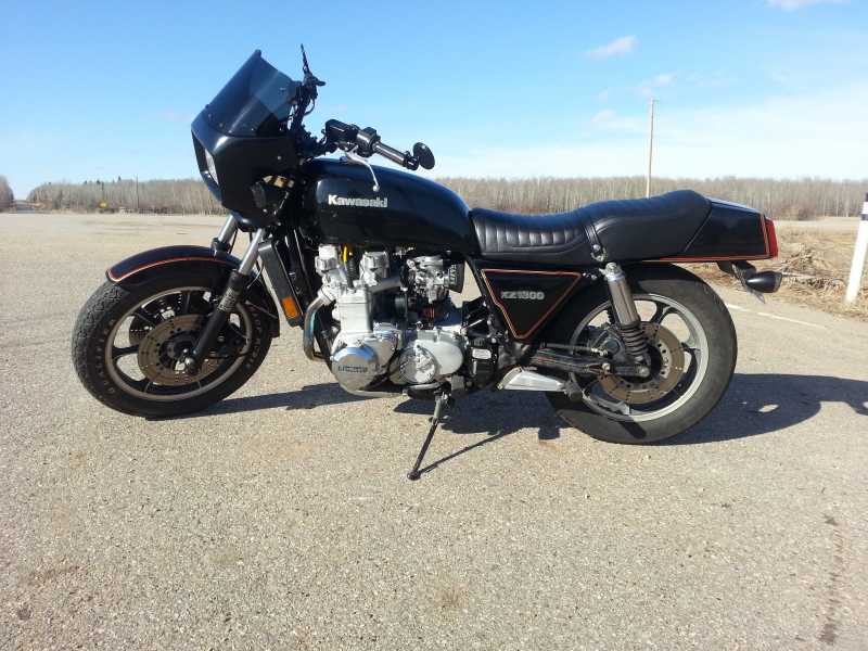

Hey guys, after a few delays, I've finished my hydraulic clutch conversion. I had a few extra plates laser cut to Pete's specs if anyone is interested - I would sell them to you for little more than the cost of shipping and my time. PM me your location for pricing if you're interested. Note - this is just the bare plate as per Pete's dimensions - 6mm thick aluminum plate, 110m in diameter with a 43mm hole cut 6mm from the edge, unfinished in the raw. You need to drill all other holes and supply all the other parts.
Since I'm not yet sure what style I'll be finishing my 13 in, I just bead blasted the parts and fitted them up.
Here's a pic of the raw plate and the final installation.

Really nice job that mate, it looks great.
I also find the clutch has more "Feel" with the conversion & obviously no chance of a cable or linkage snapping.
To anyone out there thinking of doing this, it is a great opportunity to buy the mounting plate available, as that is the hardest part to cover in the job itself.

Thanks Pete F, and thanks again for the excellent write-up and instruction. I can't wait to get it out on the road, though this is another winter that feels like it may never end!
Bob and Mike, I've replied to your PMs.

Just had my 13 out for its first run of the season yesterday, and I love the hydraulic clutch mod, such a nice light action and so smooth, thanks again Pete F for the great write up, and Bill for reposting it!
Also, I still have two plates left if anyone wants to make this upgrade themselves.
