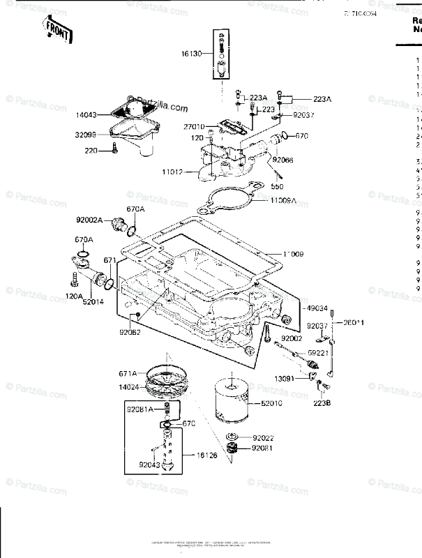

where is the pressure switch? From what I understand from studying the parts breakdown,
27010-1038 is the level switch that is inside the oil pan. It attaches to 59221-1002. Is that the pressure switch or is that just a conduit for the level signal to exit the case?

A) where is a good place to put a pressure gauge to check the oil pressure?

Yeah it does. 27010-1038
Thanks to www.partzilla.com for the drawing and info
Specifically www.partzilla.com/catalog/kawasaki/motor...4/oil-pan-oil-filter

7 years 2 weeks ago - 7 years 2 weeks agoKawboy wrote: Yeah it does. 27010-1038
I'm confused: Fiche lists 27010-1038 as " SWITCH,OIL LEVEL" - is that supposed to be 'pressure level' or 'oil level'. If it's Oil pressure then I can't find a level switch. To confuse things, the ZN1300 wiring diagram show only an oil level switch:
..while the 82 KZ1300 has this extra piece, 25025-1003 (in addition to 27010-1038), listed as a "WARNER,OIL LEVEL" and which is not shown on the ZN1300 fiche. I can't find an A4 wiring diagram so not sure what it connects to.
Maybe 27010-1038 is both a level switch and a pressure switch? Or maybe it's the pressure switch and the ZN1300 doesn't have a level switch - seems weird that the KZ would have one but the ZN wouldn't.
