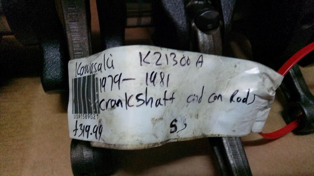

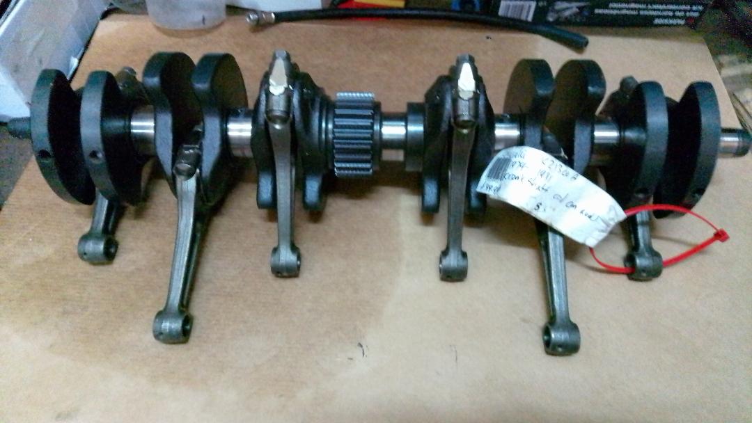

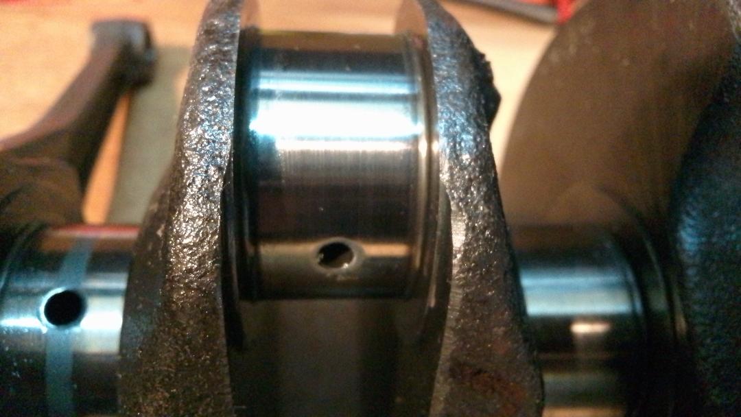

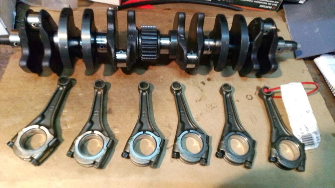

The crankshaft has arrived from the UK.It is so beautiful that I don't know whether to mount it on the engine or hang it in my living room over the fireplace next to the grand piano.
 Its condition is excellent, it comes with its connecting rods and bearings.All measurements are within tolerance values of use.
In the end its cost plus shipping and import duties was 480 euros, yes, it still hurts my pocket.
