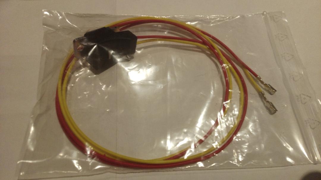

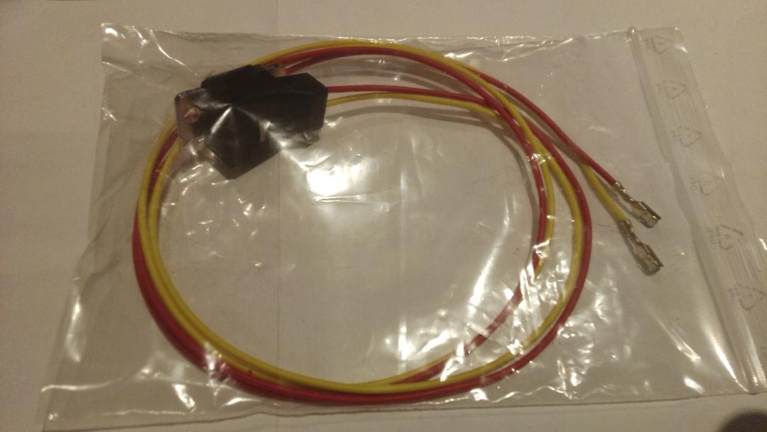

I already received the replacement from MCG Parts, everything perfectly packaged and protected in a box full of Styrofoam flakes.

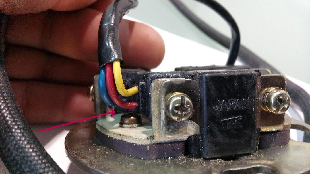

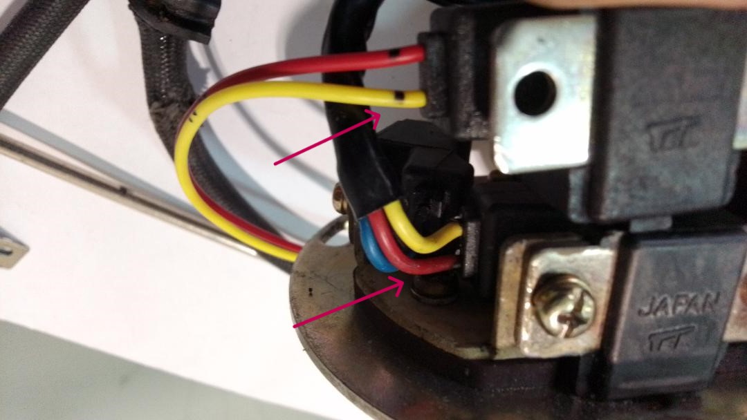

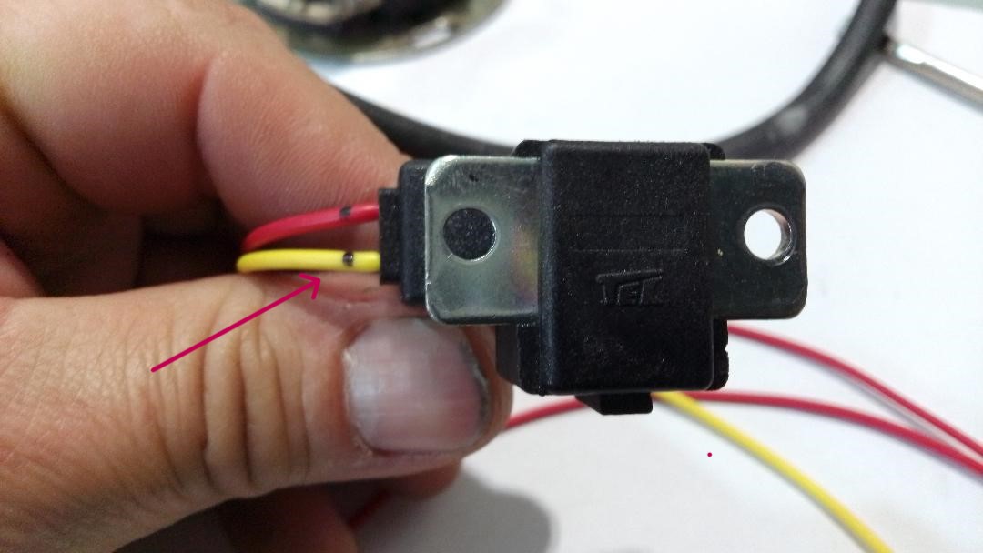

I was about to change the piece when I discovered a detail that confused me again.The old pulse generator has the red cable exit from below, near the magnet on the plate that supports it.
While in the new generator pulse it is the yellow cable that comes out from the lower part.
In this image you can see the difference between the two pieces placed in the same position.
So my question was whether I had to join the cables by their color or by their position in the pulse generator.
I sent an email to MCG Parts asking what to do and they kindly responded to me to join the cables by color, red to red, yellow to yellow.
One more step, one less doubt.
