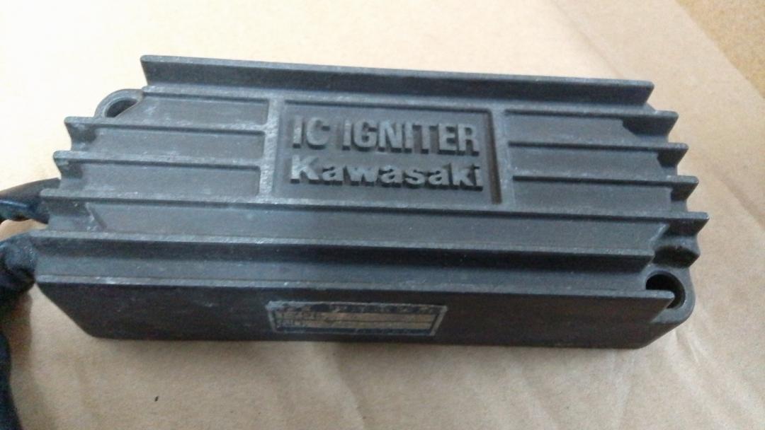

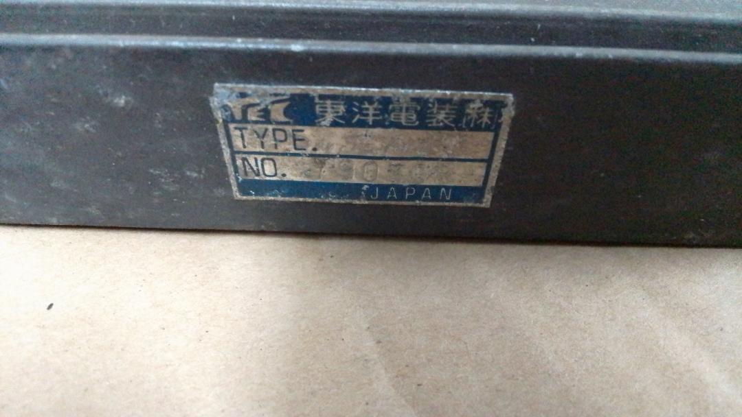

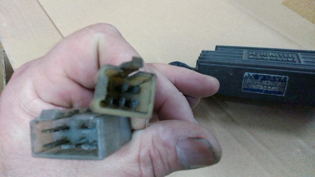

I finally received the used CDI from the French replacement dealer.
The connectors are crying out for a good cleaning.
Well, after reassembling the parts, prime the carburetors and help the battery with some additional clamps.

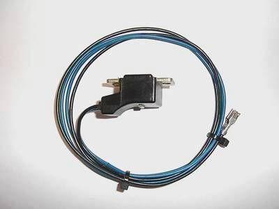

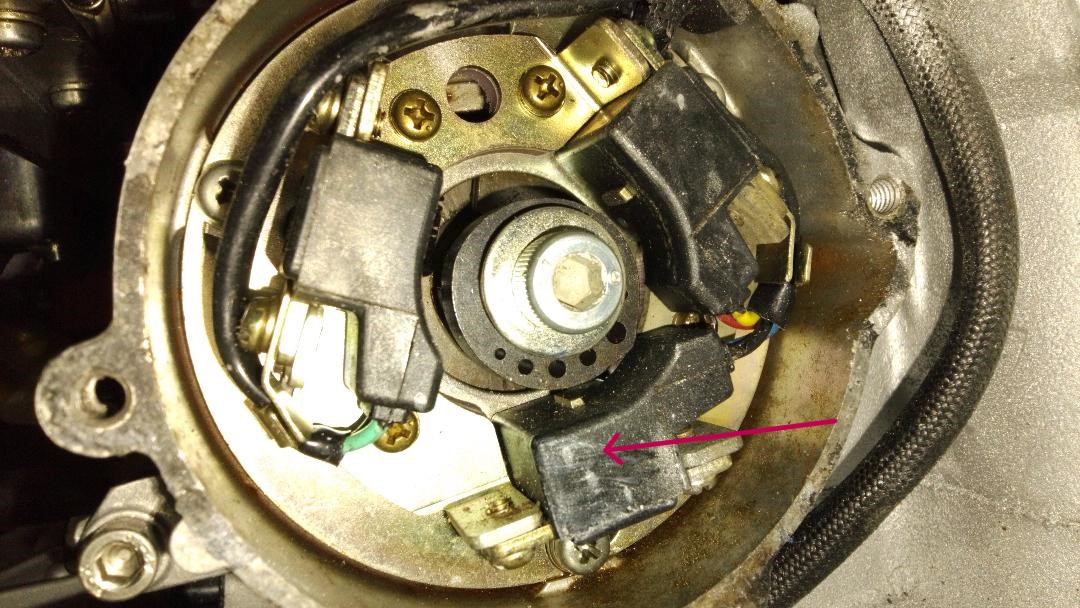

The fault comes from the pick-up.
The fault is in the pulse generator of cylinders 2-5.
It works when it wants without apparent cause.
I have already ordered a new one from MCG Parts.

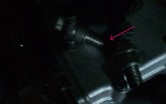

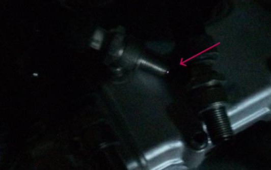

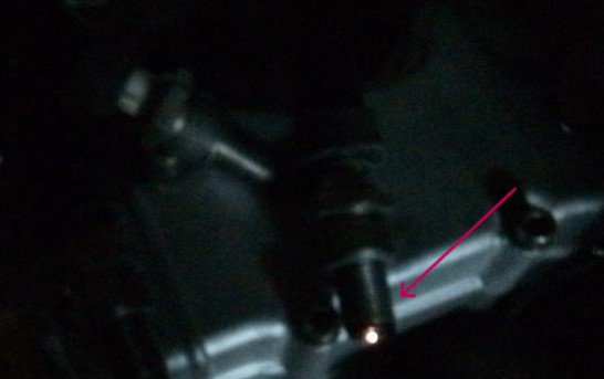

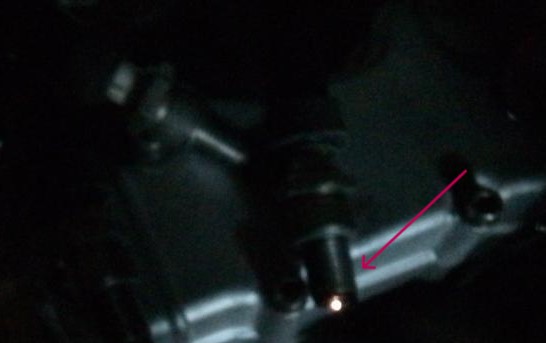

2 years 7 months ago - 2 years 7 months agoI took a couple of low quality photos at the time of capturing the spark from the spark plug.When you get it sparking again, could I ask a favor? Take a video of the plugs sparking so I can compare what I have to yours?
I was also able to record a video as requested, the quality of the video is in line with that of the photos.
From the 29th second the party begins.
The sparks correspond to cylinders 1 and 3.
Number 2 went for tobacco.
I turned off the garage light so the sparks could be seen better and to hide my mess.
Last edit: 2 years 7 months ago by kawaBCN.
