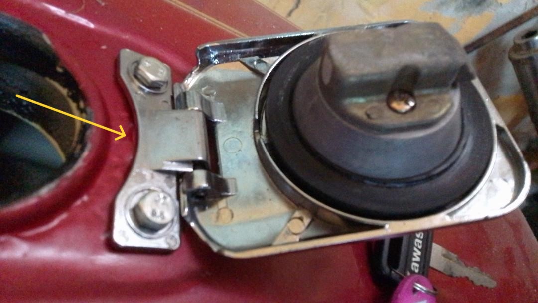

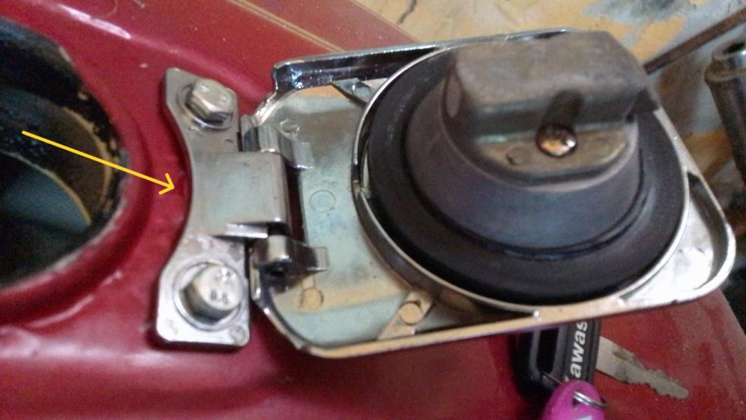

After spending my time blowing and sucking on the gas evacuation tube of the fuel tank to try to unclog it and with the result of severe pain in my cheeks.
I discovered to my surprise that the outlet of the tube is blocked by the flat base of the filler cap.
An OEM plug with its gas evacuation system is around 200 euros, an aftermarket plug, which is the one I have installed, costs 15 euros, but in an act of extreme generosity they give you a copy of the key.
My question is:
Is there any possibility of mounting a gas vaporization system without having the OEM cap?
My question is:
